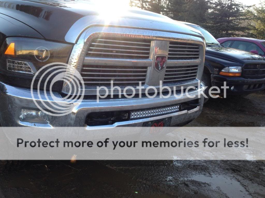

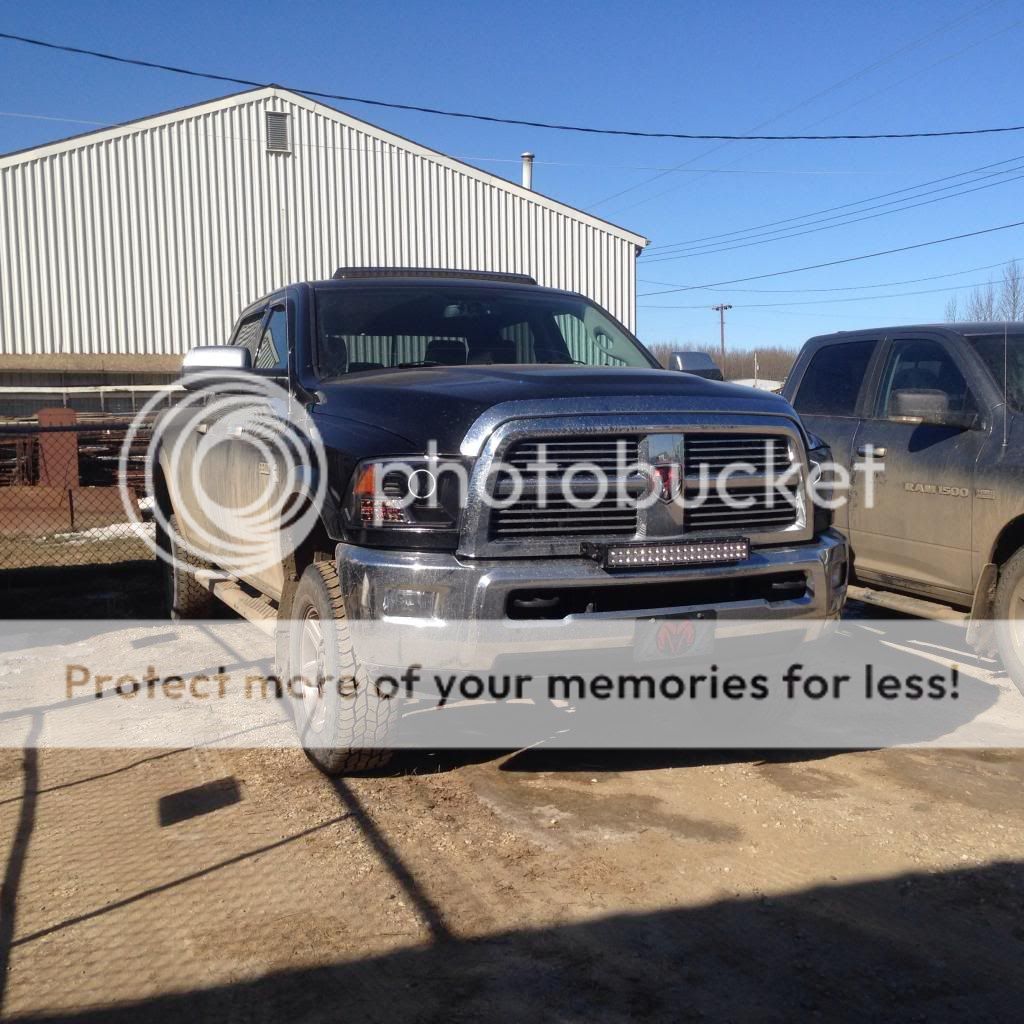

A few weeks later I decided to put my quick release grill kit from genos' and decided it was time to put my lightbar in the bumper, so I built some brackets, and voila.

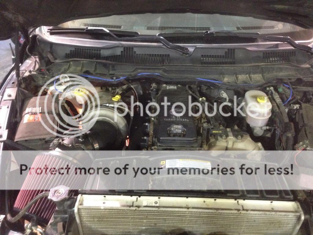

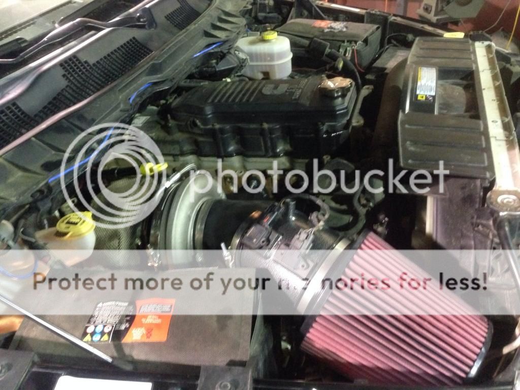

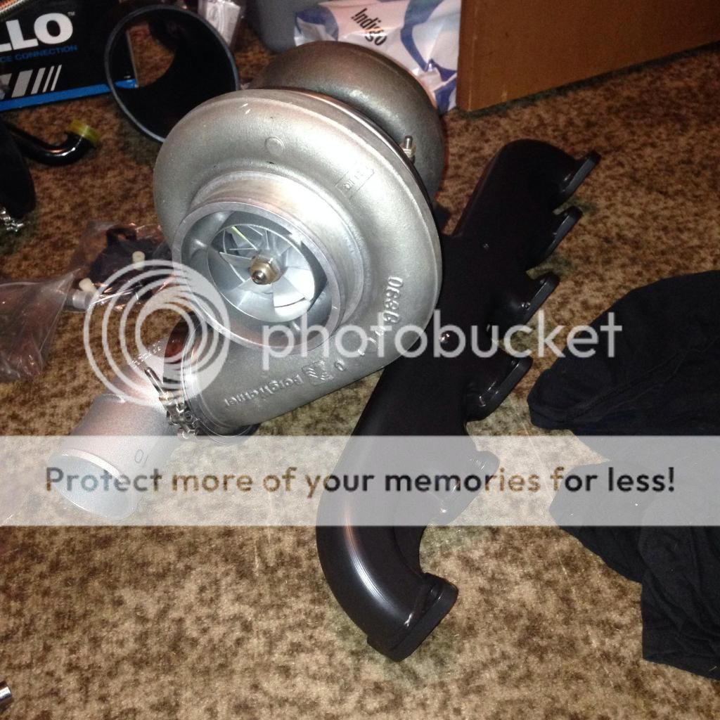

Then I got my egt baseline with the stock turbo (1900* on a long pull with the tuning I was running) so it was time for more air. I ordered a straight flange steed speed, most of a source 2nd gen swap, and an s467fmw. Then I waited impatiently for my next 3 day weekend. Unfortunately the 467 didn't come in in time, so I took the s480 I'd gotten over a year ago, and decided to stick that on.

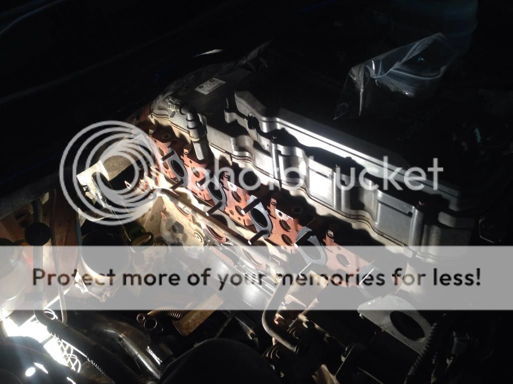

I decided to go with manifold studs rather than sticking with bolts. It made the install a lot easier
because I wanted to keep my exhaust a full 5 inches I got a flange and a 90* piece of pipe and modded my diamond eye downpipe
ooohhh, I really like the way the no-angle manifold flange puts the turbo at a nice height. Not too low, not too high.
Any issues with exh or cold air tube with it mounted at that level?
I mean if you were to do it ALL OVER again would you still with the manifold style you have?

The 80 spools a LOT faster than I expected. It's actually fully lit by around 2100rpm.
I really like the straight flange. I had some small issues fitting the 5" pipe (had to pull the heat shield that's on the coolant overflow) to get stop it from hitting, and the water line that goes into the cab doesn't line up with any of the original holes. I did get away with using a straight piece of 3" pipe for the ic pipe, but having a slight bend would be a little easier. If I were to do it again I'd use the straight flange for sure

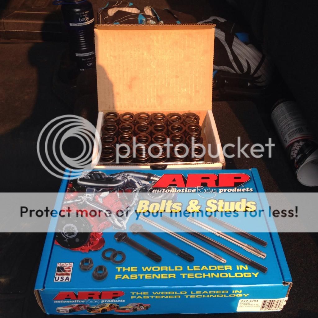

On another note I ordered a set of arp 625's and Hamilton valve springs, so I can spin this thing up some more

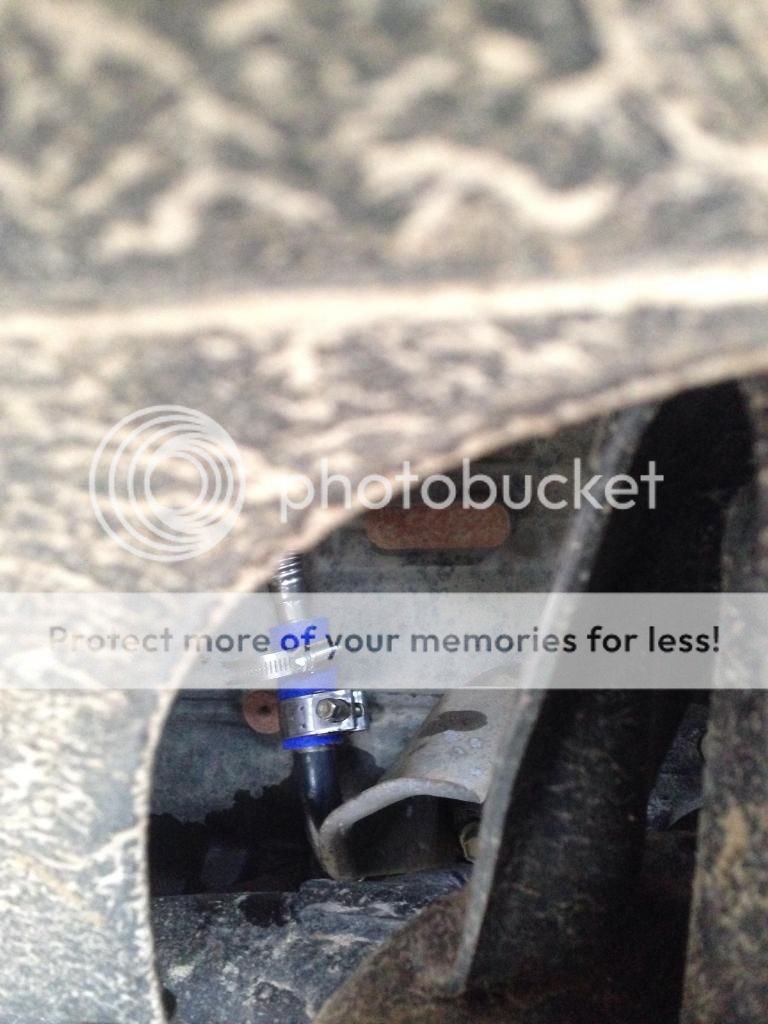

So an unfortunate thing to come from the straight flange manifold is source automotives turbo oil drain isn't quite long enough to fully go into the block like it's supposed to. This reared its head on the 800 kilometer drive to from home to lethbridge where oil started seeping past the one o-ring that's in there (basically the whole underside of my truck has a layer of oil on it). When I get home I'll figure out a way to get a 2nd gen drain nipple in there, and that'll fix the problem

Studs and springs came in. Hg might have blown yesterday though as it currently blows white smoke if I do more than 105

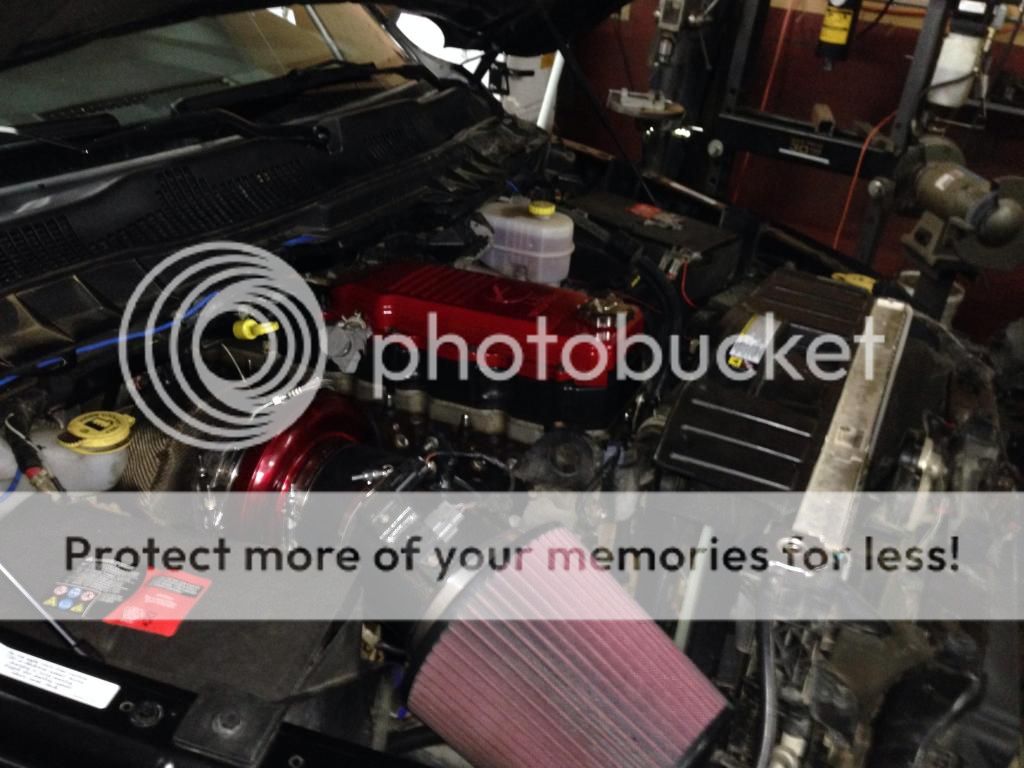

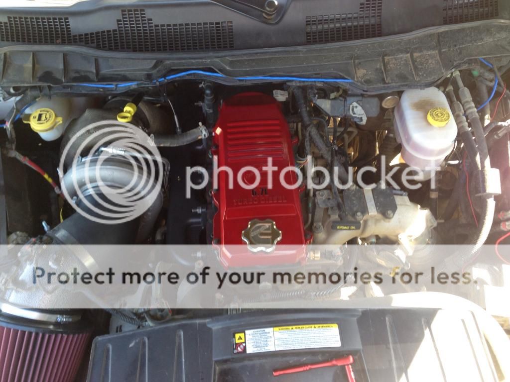

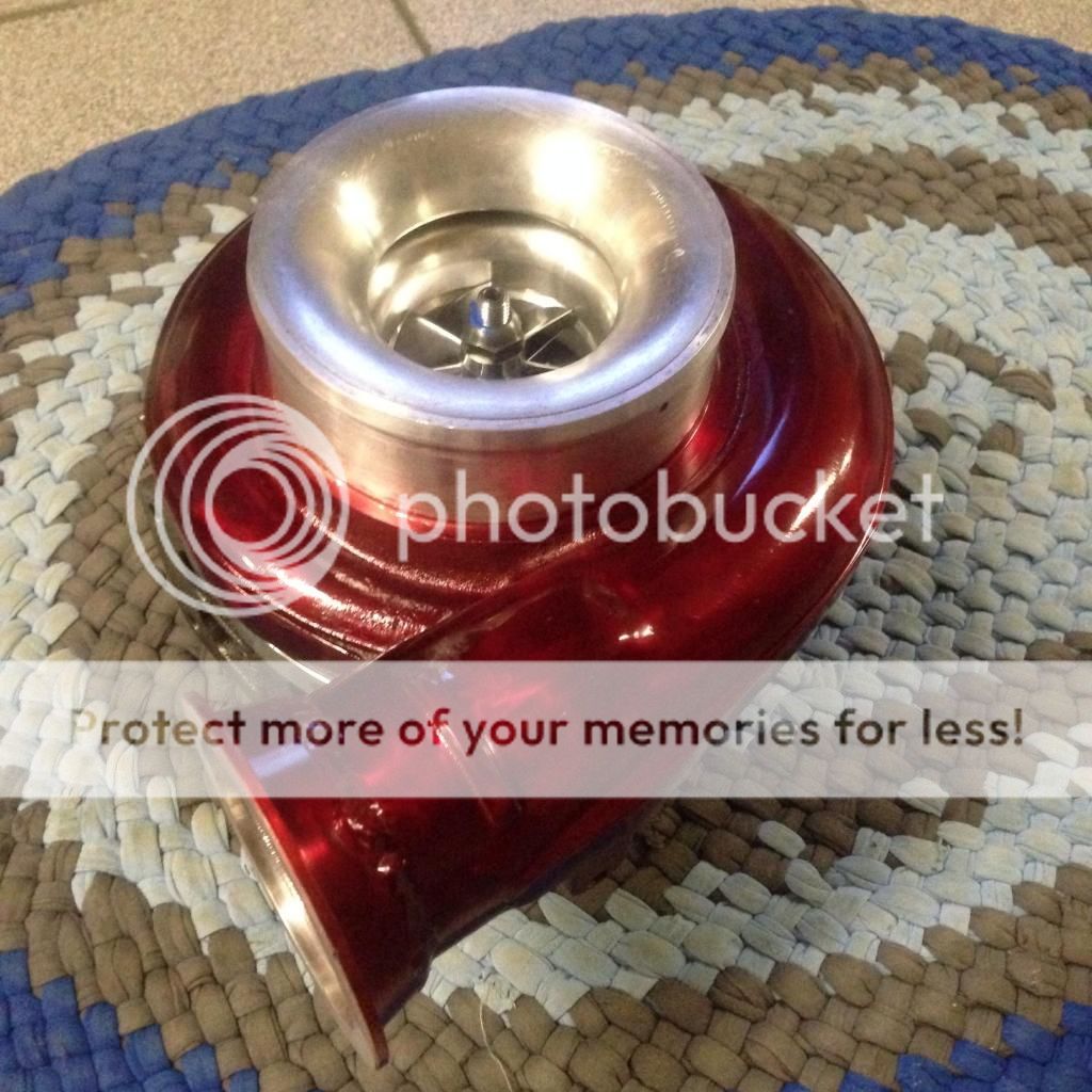

So I got my s467 today. After looking at an s480 for the past few weeks the compressor wheel looks quite small. When I got home I pulled the compressor housing off, cleaned it up, and am giving it several coats of the same red as what's on my CCV cover
#21 ·
#22 ·
I decided to paint the comp housing to match my CCV cover. The finish turned out better than expected

467 is in. Also got the oil drain fixed up how I wanted
Ran it on the tune I'd been using with my s480, and the result was less overall power, higher smoke output, and it didn't like such a high shift point. Now though I've back the duration down quite a bit, and I've gotten it to the faintest of hazes on a 3200us tune

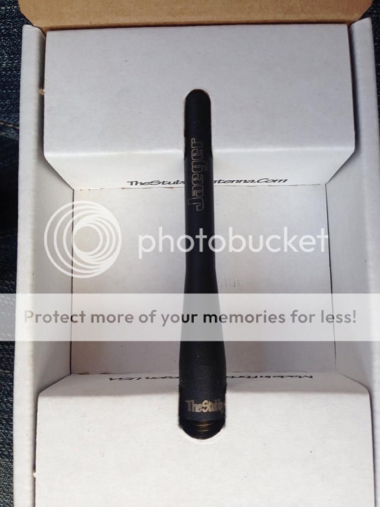

Truck parts Thursday. Firstly a stubby antenna from cravenspeed. I already had one, but I decided to get one that had the trucks name written on it

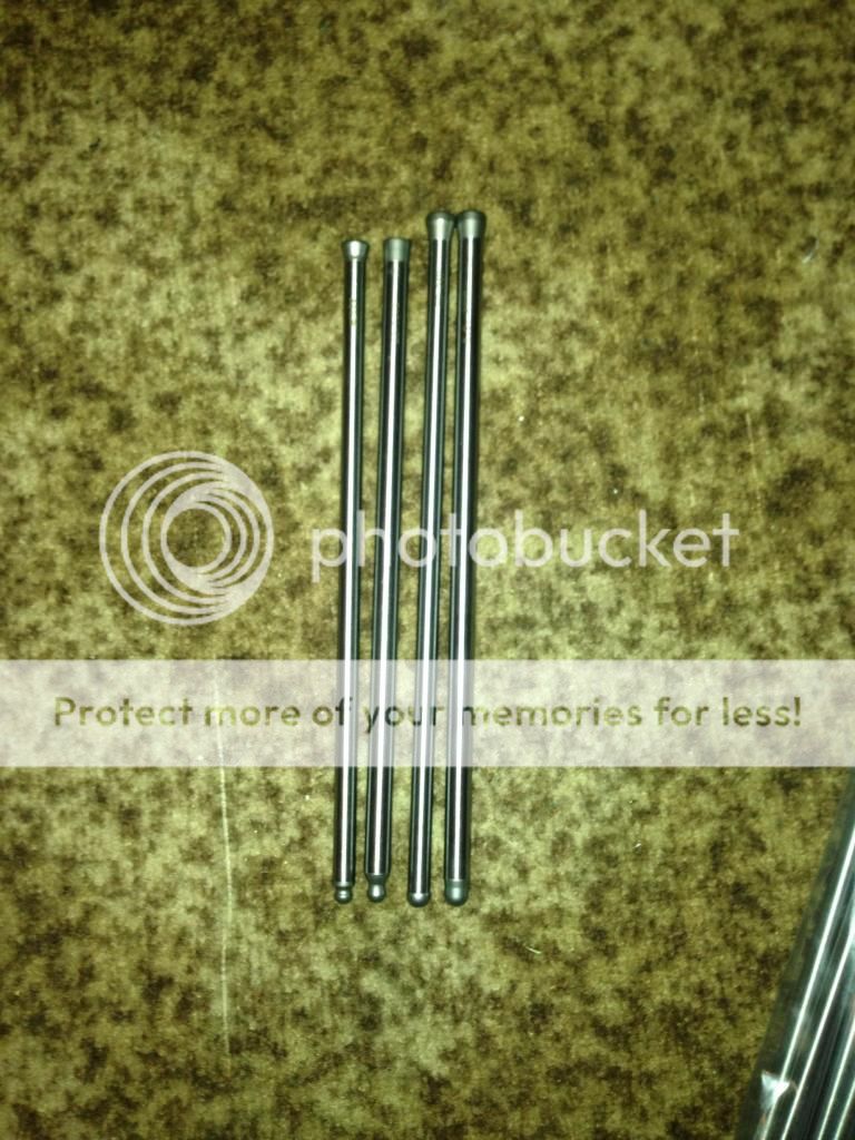

Then I got my Hamilton extreme duty pushrods in. Decided to compare them to their 12 valve counterparts (12v left, 24v right)

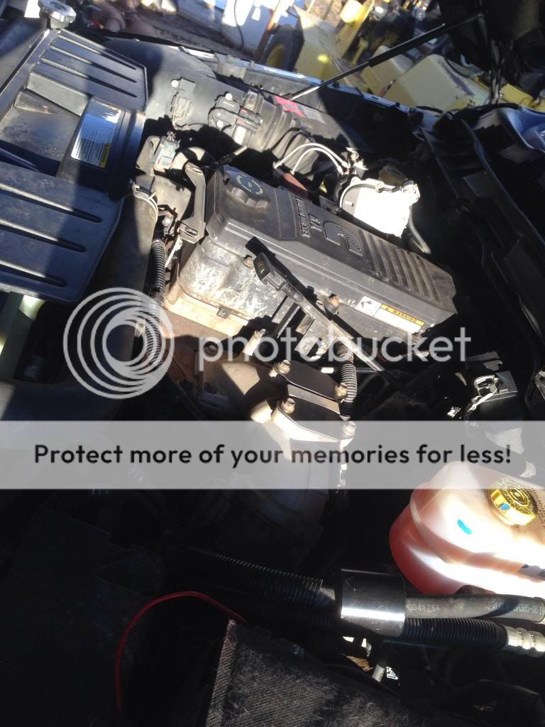

So I got my springs, and pushrods installed this weekend with some help from ehgentorange . While I had it torn down to do it I did a retorque of the studs, and found a few that had loosened a bit, so I'm glad I decided to do it. Doing the valve set was a little tricky, and to make sure I did them right I ended up doing each of them 2-4 times (they got super tight with the new stuff in there. Some of them required 3+ turns out before the spring decompressed)
