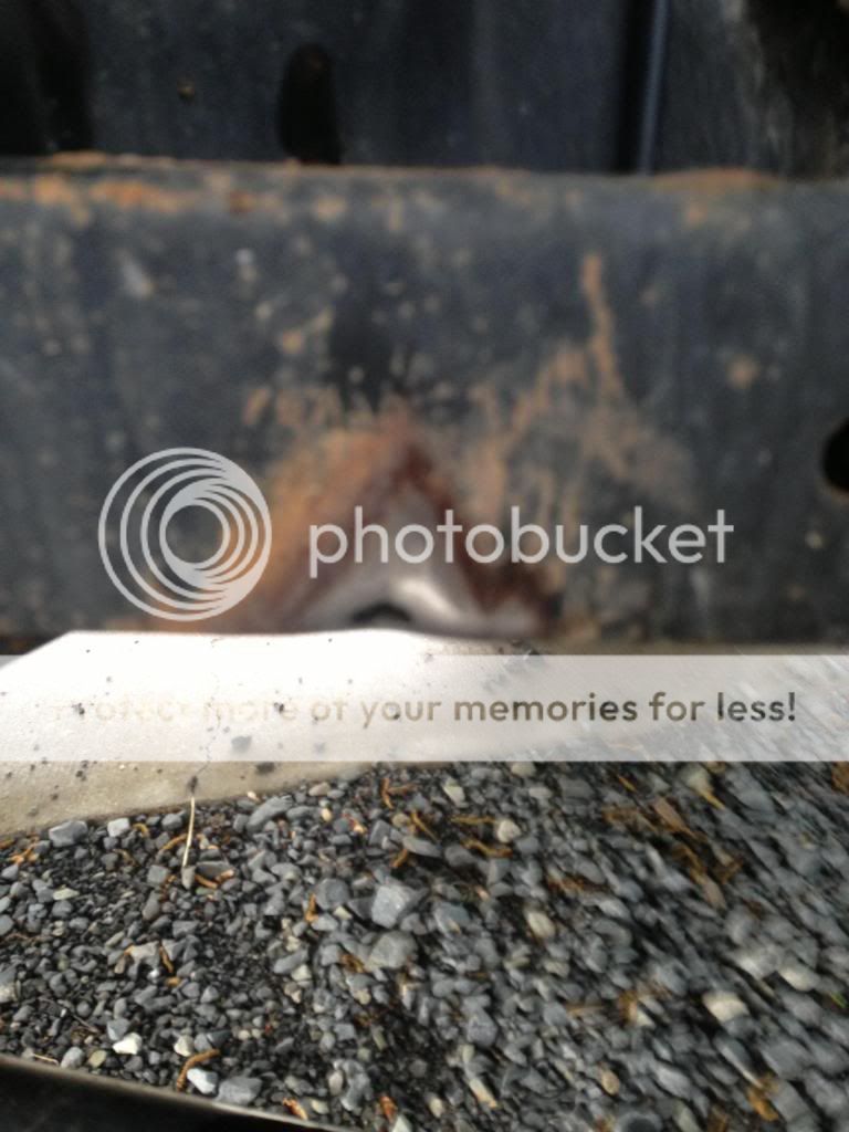

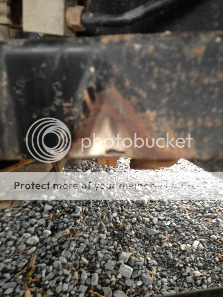

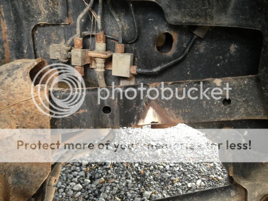

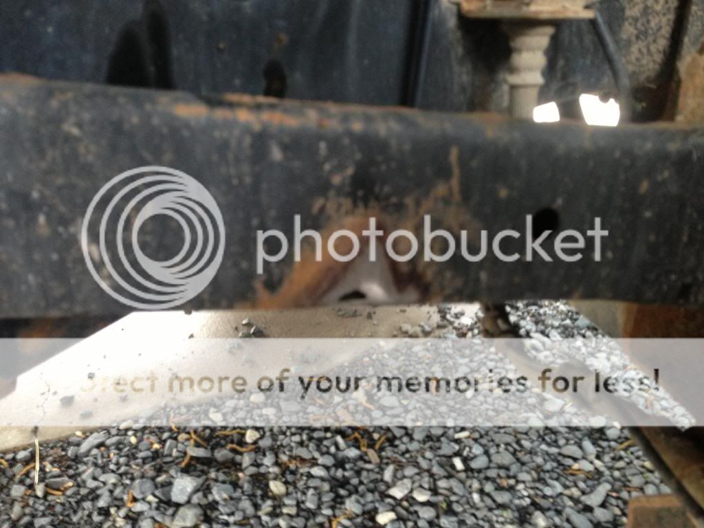

I guess I have not been so easy with no turning at full lock with my 315-70-17 and have rubbed a whole on bottom of upper control arms from the tires. Do you think I can just weld a piece of flat steel stock over the small hole and where the tire rubbed or should i just bite the bullet and order new ones?

If you are asking then your first instinct is correct. I would not weld on them since that could make them brittle. More than likely, you wouldn't have a catastrophic failure. On the other hand, I would of never thought it possible to rub a hole through a control arm...

Something is up here. A rubber tire cannot rub through a steel control arm. It would take years and years and 10 sets of tires to do that if you got them down to the cord. Maybe it rusted through after your tire rubbed the paint off? Either way it should be replaced and not fixed.

What do you mean something is up? I tried to post pictures but cant due to the 100kb upload limit. Unless there was already a hole in the middle of the upper control arms it happened! I only have 40k on the truck and have went through about 3 sets of tires not from this but just because these backroads in wv are rough.

I am not stupid the wheel is not rubbing its the tire. I didnt think that a rubber tire could wear a hole in steel either but I guess I was wrong. It only rubs at full lock but maybe with salt and sand it could of acted like sandpaper? Has nobody else with 35's had this problem? My lower control arms rub to but just rubbed the paint on not like the upper.

You may be good to go as far as welding since the steel is soft enough for rubber to rub through. Might want to research what kind of steel is used just to safe. If it were high tensile strength like they use in modern body panels, you may have issues with it cracking easily.

you can weld them i would use tig and a er70.
the rubber can wear though it only cause they so many liner inches rubbing it and truck are made of harder rubberto try and not wear

To me, i don't think this is the tires. the rubbing appears to begin the rubbing at the bottom and then goes up. If it were the tires, then unless your doing 90% of your driving in reverse, I don't see how this is possible as the point it touches would be the greatest pressure , which would be the side of the control arm, not the bottom. As the tire presses harder, the tire flattens out. This does not appear to be indicative of tire rubbing, unless as I said, your doing a lot of driving in reverse.

Now what I can't figure out is, just normal driving, down the road even during twisty sections, you should never hit "lock to lock" on your steering at any speed greater than 25 mph or so?! So unless those West Virginia roads are a daily slalom course at high speeds, 40,000 miles of rubbing to cut through the stock steel arms, is pretty serious. Even during twisty sections of some roads, paved or not, I can't hit lock to lock while driving.
So as mentioned, something just isn't right with this setup? Maybe it's as you said, white_lightning, and dirt, sand, grit on the tires, when you turn lock to lock at slow speeds, say backing into your parking place at home? Maybe you have a gravel drive that allows enough grit on the tires and as you manuever the truck around the house, you're "sanding" the steel down over time?
Give more info. Do you always drive it on paved roads daily? Never go off road and turn to the locks? You were onto something with that comment about sanding the steel with the tire... :agree2: Just need to know HOW the truck is driven. You're also onto something there about a repair. It's not carbon steel nor heat treated like the frame, so you could essentially weld on it. Coulda swore someone somewhere has made a Roller for their tire rub issue...? The roller contacted the tire first, instead of the tire contacting the arm.

The overall look has the resembleance of what a tire rubbing looks like. I just cant see how a rubber tire can burn/rub a hole into metal.

All of the dirt and asphalt on the tires turn them into a belt sander. I could see how tires would rub a hole in the thin metal over time.
