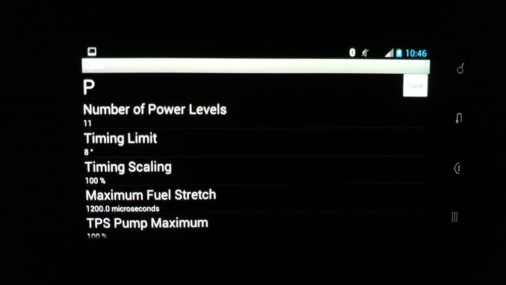

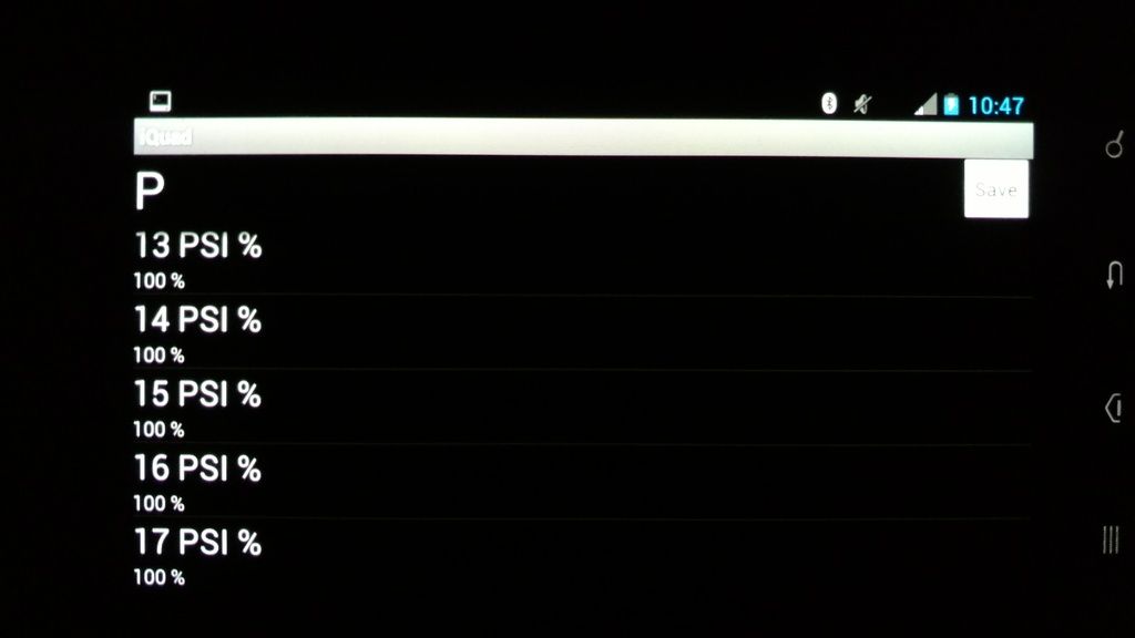

So what is V2? Basically it's a way to gain more control over the tuning parameters, with an emphasis on CLEAN POWER. I've got big injectors, and I've driven my own truck enough that I can drive it virtually smoke free, but I have to be very careful with the right petal (even when set to stock)
Here are the custom tuning parameters:
Alright, let's start with the power levels:
0=stock
1=Power Percent (Explained later)
2=Fuel mileage (Same as the old number 1)
3=can-bus only (Same as old number 2)
4=can-bus + wiretap (same as old number 3)
and so on to the maximum level set is reached.

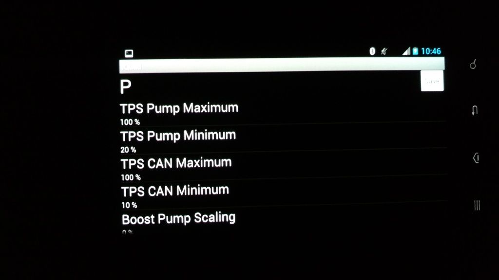

So, as you can see the first 8 parameters (through "TPS CAN Minimum") are the same as they've always been. They will function just like they used to.
The next two have to do with wiretap fueling. The "Boost Pump Scaling" gives the %specified of called for wiretap fueling if the boost is below the "boost pump low limit"

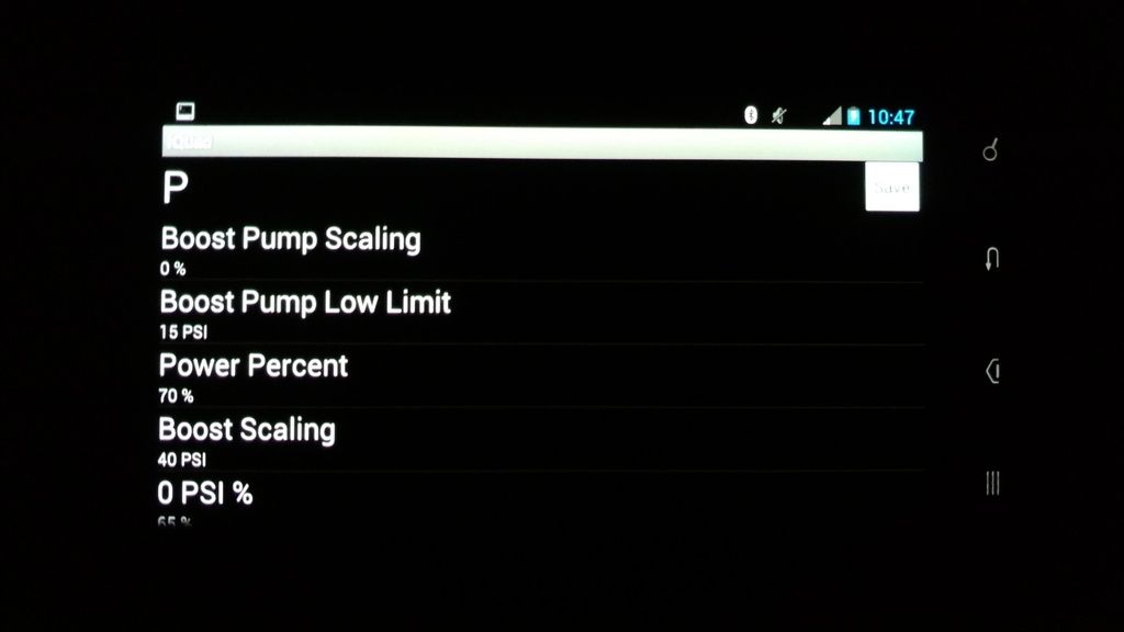

As an example: (Let's say it's set on level 10) In the pictures you can see I have the scaling set to 0% until 15psi. This means I'll get zero wiretap fueling until I hit 15psi of boost. If it was set at 50% I would get 600us of wiretap before 15psi.
This greatly reduces the amount of smoke output without reducing your peak power.
Next we have Power Percent. This is the "new" level one! Here we have the percentage of stock power called for at all times. This is perfect to use for emissions testing, letting the wife/kids drive etc. This is also another way to reduce smoke if you're wanting to be really clean.
Next is boost scaling. This is the same as it used to be. Just a smoothing feature.

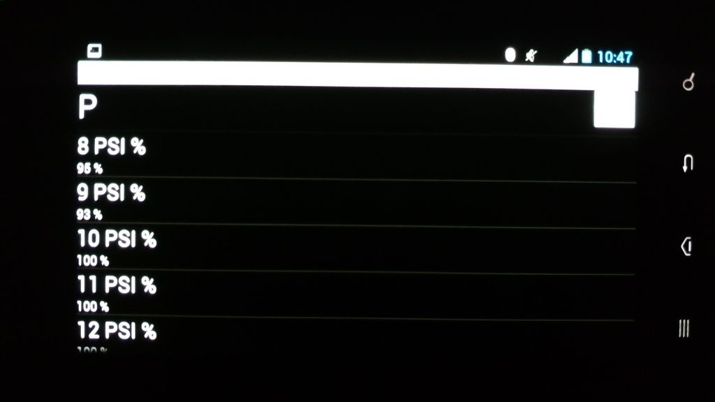

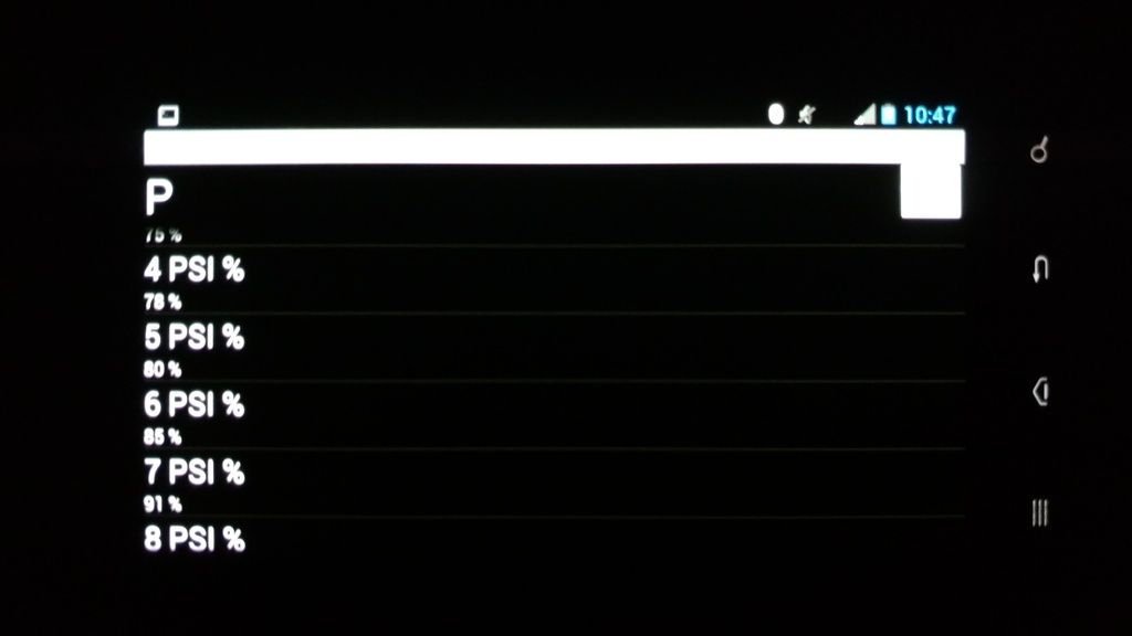

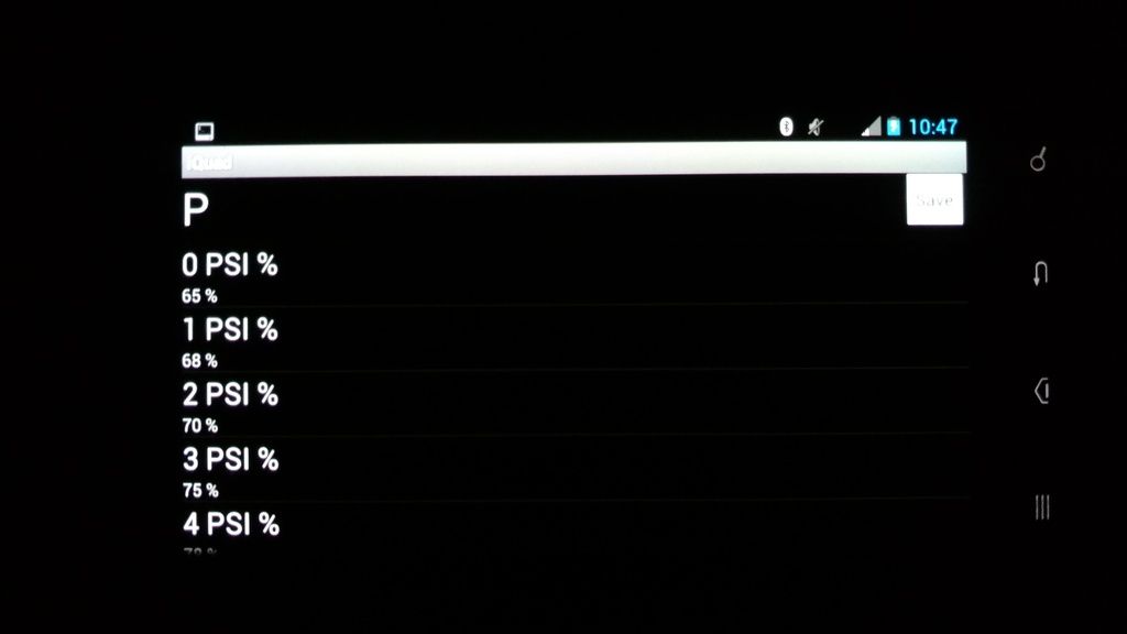

Next we have PSI% listed 0-17 in increments of 1. This feature allows you to set the amount of stock power based on boost. It allows you to ramp up the power from 0-17psi, effectively reducing smoke and making the truck more driveable.
Now for my experience with testing.
Level 1: With my truck stock, I can floor it at any time and create quite a cloud of smoke. You'd swear I have a tuner cranked, but it's not. With my truck set to 70%, I can floor it while doing 55mph in 6th and get as big of a puff as a stock 24V. Meanwhile it'll pull about 34psi @ 2000rpm and 40psi by 2500rpm. It does make the truck a little doggy, but I could adjust the percentage up as I saw fit and still keep smoke to a minimum. This would be perfect if someone were to borrow my truck (never going to happen but you get the point) They could try to hotrod it as much as they want but won't be able to. I do think this would make emissions a breeze to pass, and it could be used as a safety device to keep the truck from being stolen. Essentially you can set it to 1% and the truck would only idle.
Now for the PSI%: With the power level turned up around 1500rpm I can stab the throttle (0psi of boost) and get nothing more than a slight haze until the boost picks up and the quad starts fueling hard. Spool is still excellent under these conditions, I just need to work on my top-end fuel command to reduce the smoke up there. This has made the biggest difference in CLEAN power. The quad is essentially rolling into the throttle for you as the boost comes up so you don't cloud the highway when you get on it.

#3 ·
Based on that sneak peak review sounds like quad has some more tricks up their sleeve. Congrats on being a guinea pig.
Reactions: QuadzillaPower
Yes, there is a lot that can change and be upgraded. The quad has the capability, it's just unleashing its potential :stirpot:
50 miles on it this morning. My happy spot for level 1 is 75%. 70% it was just too lethargic. At 75 I get a tiny puff of smoke and boost ramps up to 40+ as rpms increase. I have a very hard time breaking 1,000* exhaust temps on this setting. Running as hard as it'll go from 0-75 exhaust temps were 985, and boost 42. All with just a baby puff of smoke when starting in 2nd. I did have it to the floor from the get-go too. No rolling into it. I'd get a video if I didn't have to steer, shift, and record.
One thing I'm not happy with is level 2 (the new level 1) It seems to be defueled from what it used to be. It's acting just like level 1 for some reason.
I'm still working on the can-bus tuning. I've got it to where low end smoke is very low. Just a slight haze and a puff. The puff comes out when the boost climbs above the 17psi threshold.
The only thing I'm not satisfied with here yet is the jump once it's above 17psi. When I have it to the floor it's not an issue; Barely noticeable except the puff of smoke. The problem comes when I hold the throttle constant. Ex: When I hold it at 25% throttle the boost will steadily climb from 0 to 17 then jumps straight to 36 and the power comes in hard. I don't like the way it does that at constant throttle. I'm not sure if this is something I can tune out, or of the tuner can work on it.
More to come....

Tyler and I have both found a bug where sometime for some reason the custom tune doesn't apply it's settings unless you cycle through the power lvls and back to the level you want. It's been reported to the developer
Spencer and I went over the way the custom tuning works for the beta release for 0-30psi user tuned canbus. I have a happy tune for my truck, but my truck is an automatic so I don't know how that will work with your truck.
Power lvls: whatever you like
Timing: 8
Timing scaling: %80
Stretch: 1600-1800
TPS pump max: 100
TPS pump min: 20 ***This still works as it used to
Boost scaling: 35
Power reduction: 65 ** this only applies to lvl1, 100 will give you 100% of oem fueling 65 gives you 65 of oem.
Pump low PSI: 10-15 depending on where your truck normally lives in terms of PSI Set this above where you typically drive when just cruising.
Pump low scaling: 0 ** stay at 0 until you get canbus tuned. Once you are happy with canbus fueling then bump this up by %5 until you are happy with smoke output vs power vs driveablity. This can be used to give a little more meat under the curve when you want it.
0psi: 76
1psi: 77
2psi: 78
3psi: 79
4psi: 80
5psi: 82
6psi: 84
7psi: 86
8psi: 88
9PSI: 90
10psi: 92
11psi: 94
12psi: 96
13psi: 100
14psi: 104
16psi: 108
18psi: 115
20psi: 120
22psi: 125
24psi: 130
26psi: 135
28psi: 140

TPS pump max: 100
Boost scaling: 35
0psi: %76
1psi: %77
2psi: %78
3psi: %79
4psi: %80
5psi: %82
6psi: %84
7psi: %86
8psi: %88
9PSI: %90
10psi: %92
11psi: %94
12psi: %96
13psi: %100
14psi: %104
16psi: %108
18psi: %115
20psi: %120
22psi: %125
24psi: %130
26psi: %135
28psi: %140

If it is a little low on power off idle / down low you might bump all pre 10psi settings by ~%2 - %4. I don't know much much the auto helps on take off so my tune may be too weak down low.
Tyler's truck was easy to get off the line, but his fire hose injectors might be keeping him from having issues. His starting point is ~%65 I think
As a note to everyone you don't need to increase % as you increase PSI, you can actually drop % after the 1st psi to help with off the line. Even if you set all values at %100 the truck will gain power because the ecm is requesting more power based upon it's own maps.
IE:
0 psi: %80 // this will give you good offline power
1 psi: %78 //this will help with smoke
2 psi: %77
3 psi: %78
4 psi: %79
5 psi: %80
6 psi: %81
7 psi: %84
8 psi: %88
etc
etc
etc
So don't be afraid to move up and down on the scale.
Also if you are looking for the right % to start at, don't be afraid to use lvl1 and set the power reduction at %85 then take off, if the truck is too slow bump up by %1, if the truck blows smoke drop by %1. Find the happy spot and use that as your starting point for the custom tuning. I guess it is like the 12v guys do when the look for good spool with only having haze.
