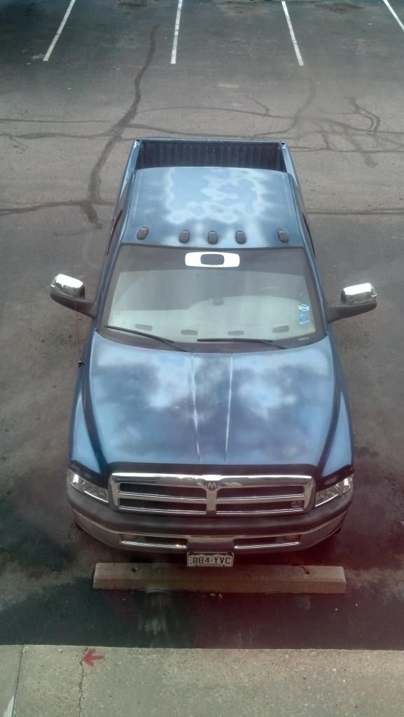

Off-Road the original grill had a broken piece on the right side that was held on with aluminum tape (PO's work)

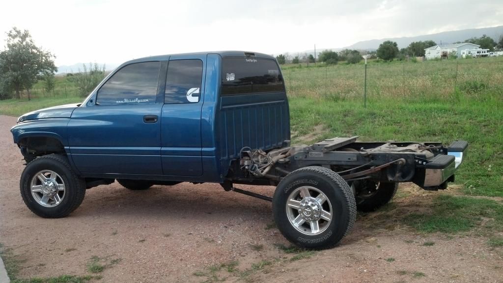

Ed I'm not sure if you've driven something with a lot of power when there's no bed and no interior but WOW I was able to spin the tires in 5th gear and I was pulling so hard on the steering wheel I thought I was going to break it off :rof
#16 ·
Ed I'm not sure if you've driven something with a lot of power when there's no bed and no interior but WOW I was able to spin the tires in 5th gear and I was pulling so hard on the steering wheel I thought I was going to break it off :rof[/QUOTE]
Good lookin truck bud! And I still had my interior in, but I drove mine without the bed which I have a toolbox that has a ton of weight in it off... And yeah wow! I couldn't believe the difference. You can't keep the tires from spinnin:thumbsup:
