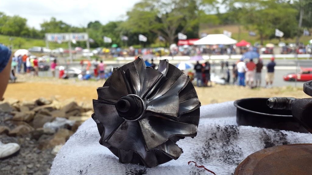

Just food for thought.
This was two days ago at the races. Gated S300 billet 63/68 T3 over box T6 475/96/1.32.
Using small 40% injectors and running my max tune on 80% trying not to break out on time. Wastegate was looser than normal and primary was working good, 32-35 psi. Very close to 800hp.
The blown turbo could have been damaged already but I can't say 100%.
The turbo had 0 contact and within spec about a week earlier measured by dial gauge.
#22 ·
You know what overall boost is on that wayward? We should do some calcs to figure out the secondary P/R. I wanna know why that SOB failed cause by the numbers it looked like it shouldn't have.
#23 ·
I'll pm to not muck up this thread. The wheel made contact first I believe.
Wastegate also wasn't moving freely. The bolt threads jammed on the housing they slide across.
#24 ·
