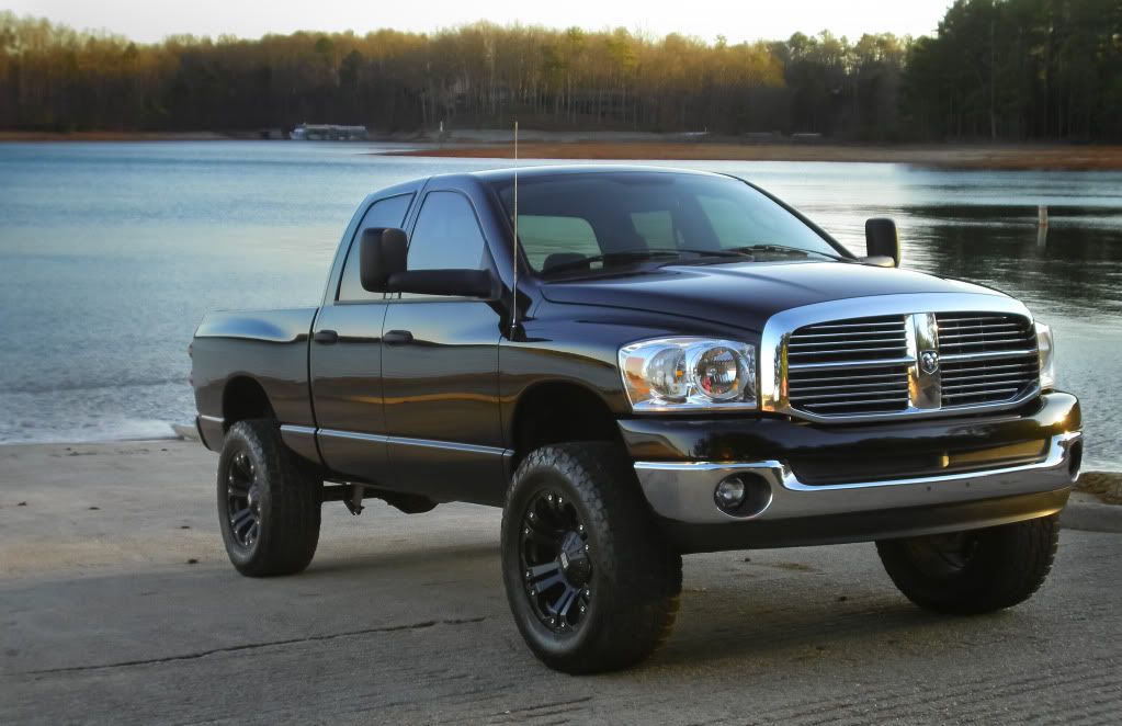

Easiest way to know is the body style. 3rd gens look different
3rd Gen ( has cp3 injeciton pump and ( 250/305 hp)
2nd Gen ( has vp44 injection pump and 235/245 hp)
You can look at the engine sticker to see what it is rated at, but really it shouldn't matter....
stock 2nd gens are SLOW regardless.....really so are stock 3rd gens.
If you are looking at HP numbers then you will likely be modding...which then means it doesn't matter really what you start with ( unless you want over 700 hp)

if its a 2002, its a second gen. auto and 5 speed manual have to 235hp engine, the 6 speed manuals came with the 245hp HO.
vin code would be 7 instead of 6 if it's a manual/HO... vin code 7 245hp/505trq vin code 6 235/435
2003 changed the HEAVY DUTY cummins body style and it's NOT the one pictured in the reply above.
the original reply poster is confused..
2002 body style changed for the base 1500 models not 2-3500...
