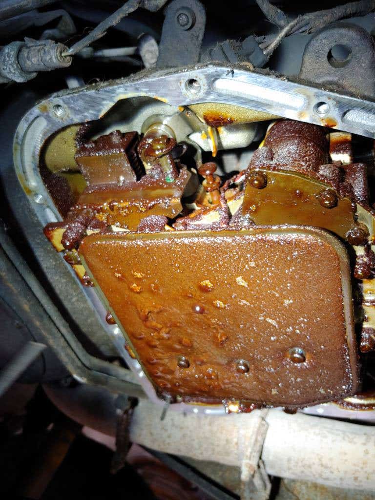

Just for reference, I'm planning on building up a mild truck MAYBE 300hp tops. Light to medium towing once a month or so.
Anyway, the transmission is junk and burnt to a crisp (photos below for s&g's) and is in need of a rebuild. I'm looking at a revmax torque converter but don't know where to get the rest of the kit from. Was looking at Oregon Transmission's kit and it looks good but wanted to know if anyone had a better recommendation.

Nothing wrong with putting in a decent higher efficiency/slightly lower stall converter, turning up the line pressure, and using a GPZ rebuild kit, at the power levels you're after with the A518.
No driveshafts to alter, no wiring to add/alter, keep your first gen starter/adapter plate, no support to extend/notch, and the non lockup converter is cheaper; no lockup clutch to wear out to boot.

So looks like the OP doesn't want the "non standard non restoration look" of adding a single wire for lockup, but is OK with cutting an extra couple holes in the floorboard.

Going to take a look at the heat exchanger this weekend. Was simply going to bypass it for the time being in case it is contaminating the tranny fluid. It looks like the coolant has one inlet/outlet by the alternator and another down by the oil filter. I plan to plug the coolant passages on the exchanger and run a bypass hose between the two coolant connections. This sound like a good method to y'all?
Haven't had hands on the truck over the last week, so I need to check the coolant for trans fluid as well. Going to try flushing the front mount transmission cooler and clean up as much as I can with the trans in the truck before tossing in a new filter and fluid and just see what the transmission does. I don't expect it to be fully functioning or roadworthy, but am hoping it is enough to get around the ranch for the time being until I decide on what direction I want to take for a rebuild or swap. There have been lots of good recommendations and points made, but I was getting a little too worked up lol. Decided to slow down and reassess my budget, options, and build plans.
#35 ·
Well bypassed the heat exchanger and cleaned up the transmission as best I could, tossed in a new pan filter and fluid and added about 7 quarts to get back to full. Truck moves and drives pretty well to be honest. Goes through all the gears and has enough bite to spin the tires in the dirt with just a bump of the throttle. It def leaves a bit to be desired as I think the TC is pretty loose. Something I noticed is when putting the trans in reverse it loads up then there is a buzzing coming from the transmission. Anyone heard of this issue before?
Sent from my LM-G710 using Tapatalk
#36 ·
Update: it's more of a hydraulic whining tbag happens in every gear but is worse in reverse.
Found that after a bit of driving the transmission started slipping more and more as I would get in it. Seems like it's fluid starved eventhough it's topped up. Guessing the filter is clogged or the pump or tc are shot. Will keep everyone informed!
#37 ·
It's possible the filter could be plugged up as bad as it looked before. Without tearing it down it's pretty much impossible to get it really clean.
