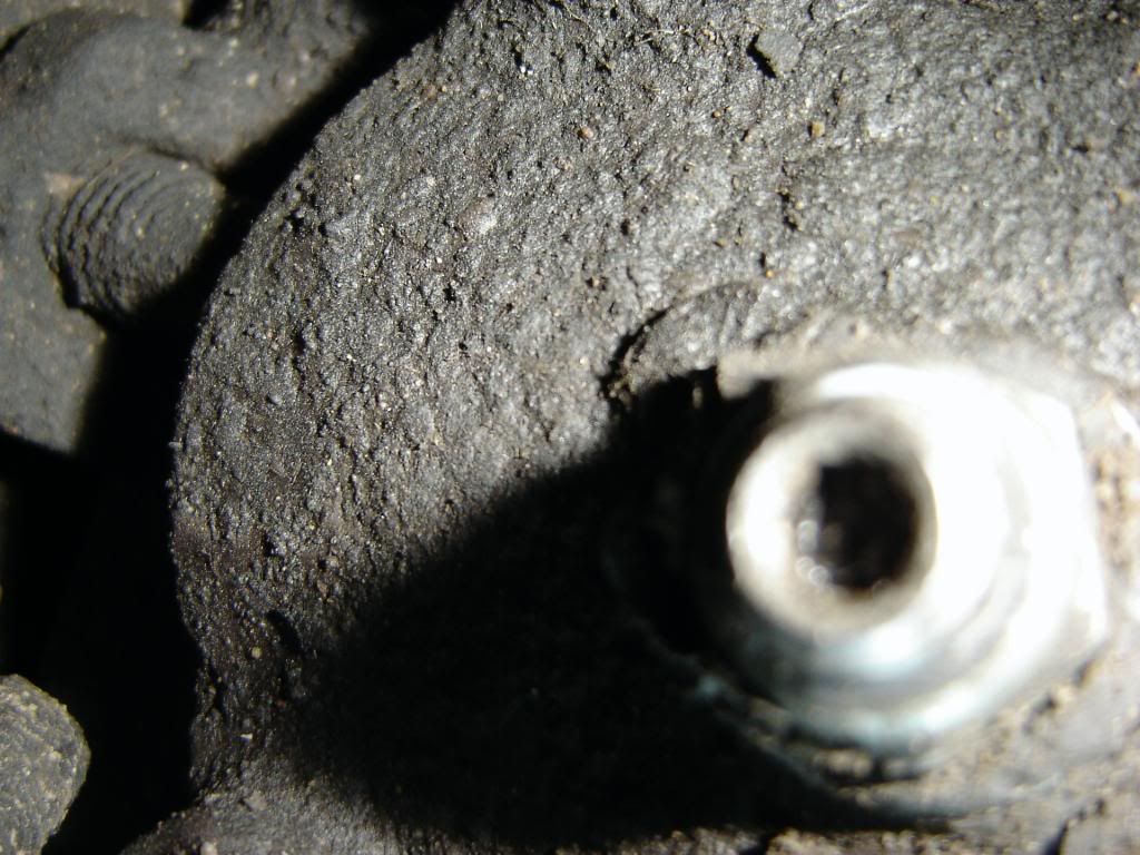

This is the over-center adjustment screw.
Up close and personal!

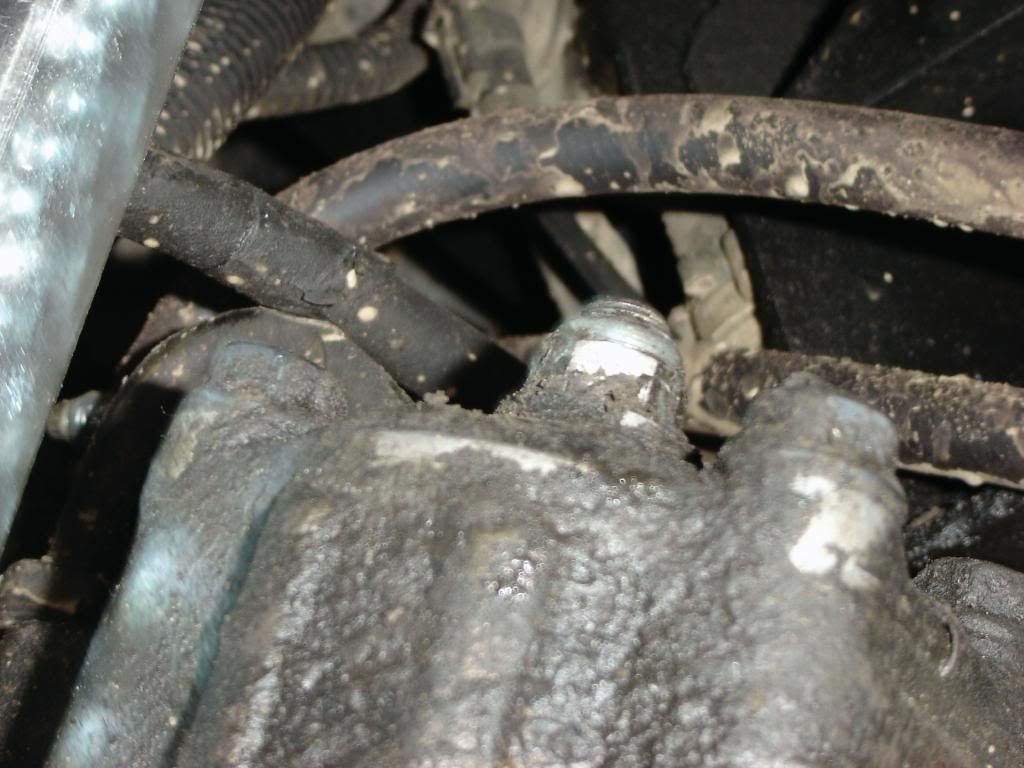

It's located on the top of the box!

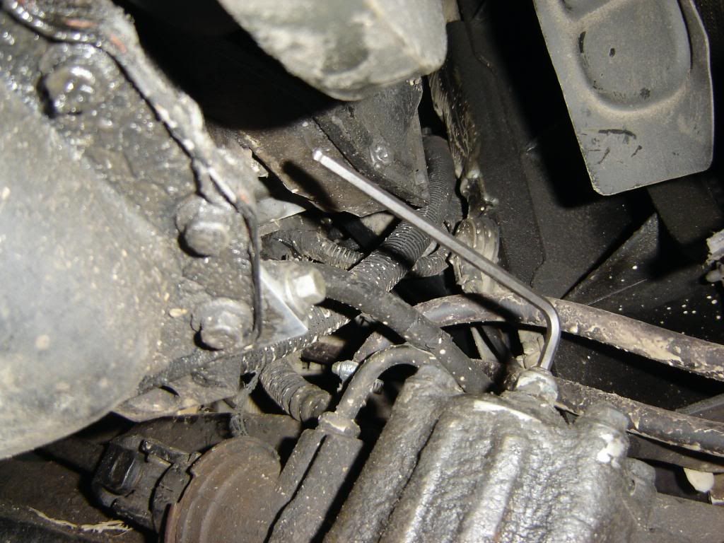

Where is was at...

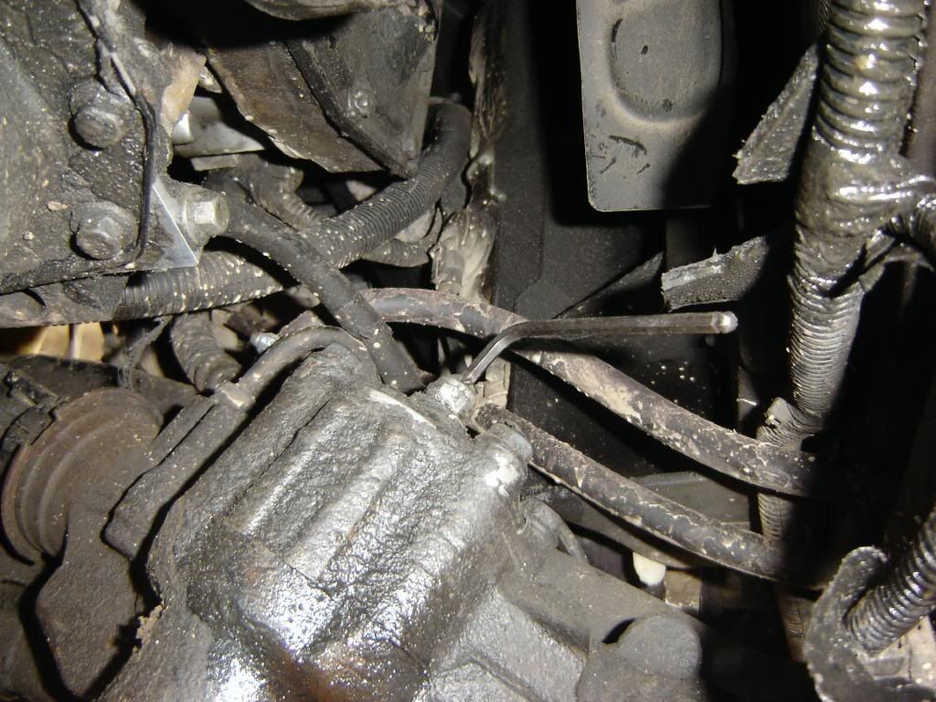

Where I adjusted it to!!

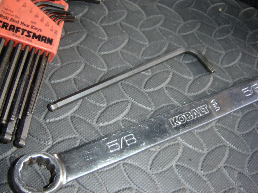

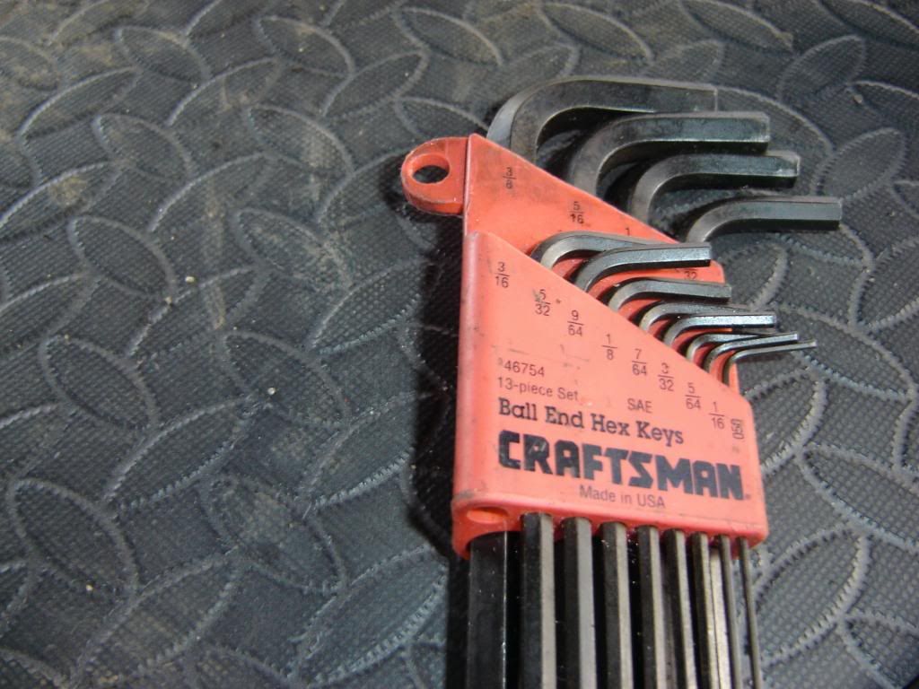

The 3/16 is what is used to adjust it!!
And a 5/8" wrench.

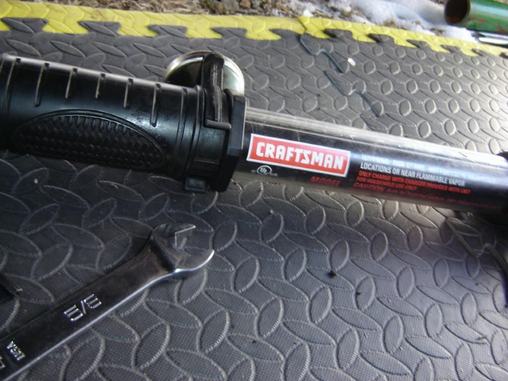

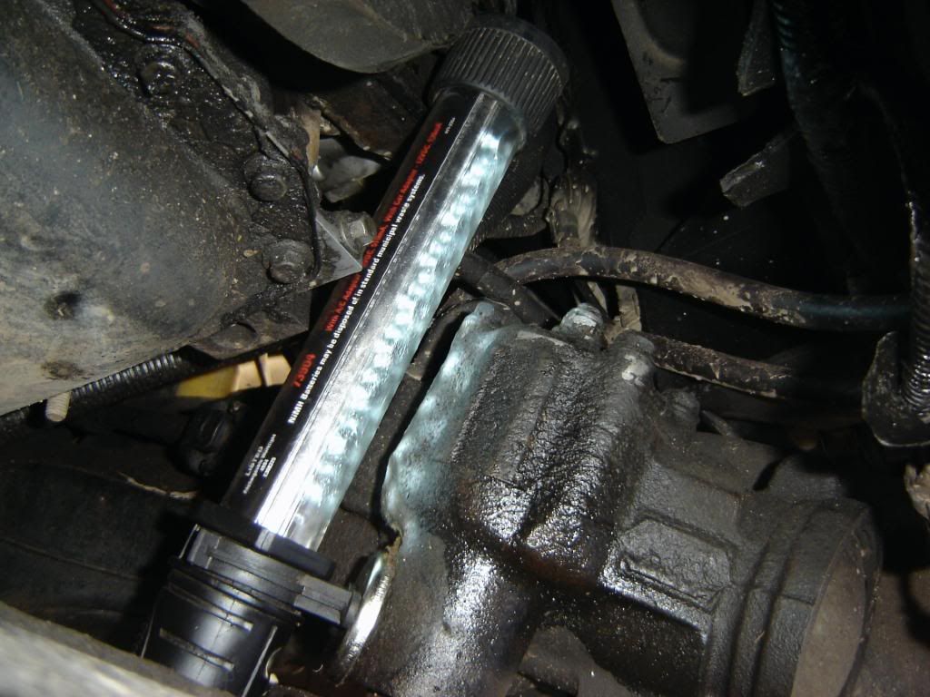

Putting some light on the subject!
It made the truck better going down the highway and it feels more responsive!!!!:party018:
