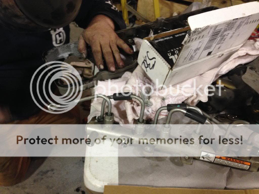

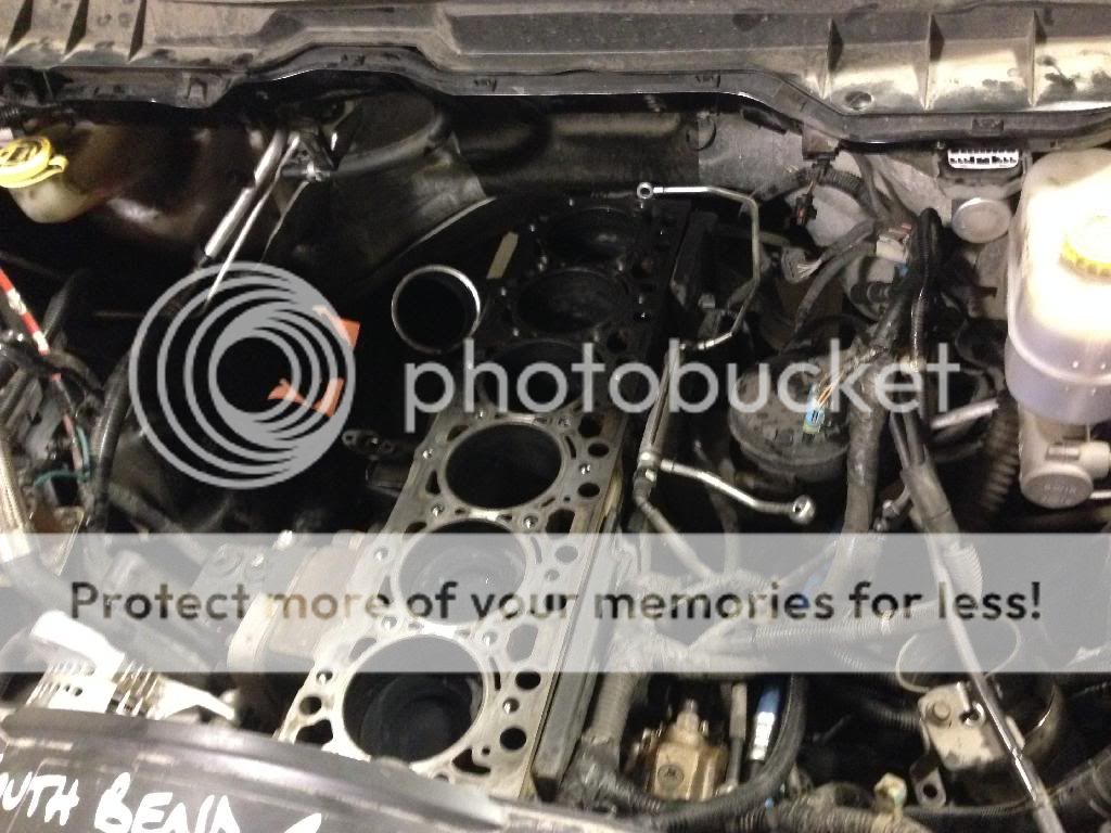

#80 ·

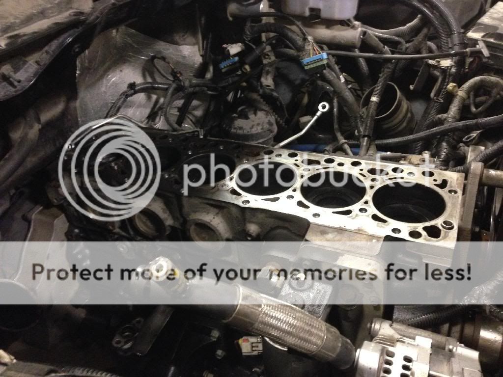

Well started on my truck today.
After getting it tore down found the problem.
Have the new gasket installed and head back on with new ARP studs all torqued.
While the head was out did the 100hp nozzles
Tomorrow putting rest if the valve train back together and then the 2nd gen install. If everything goes well I'll be driving it out of the garage tomorrow evening.
Chad

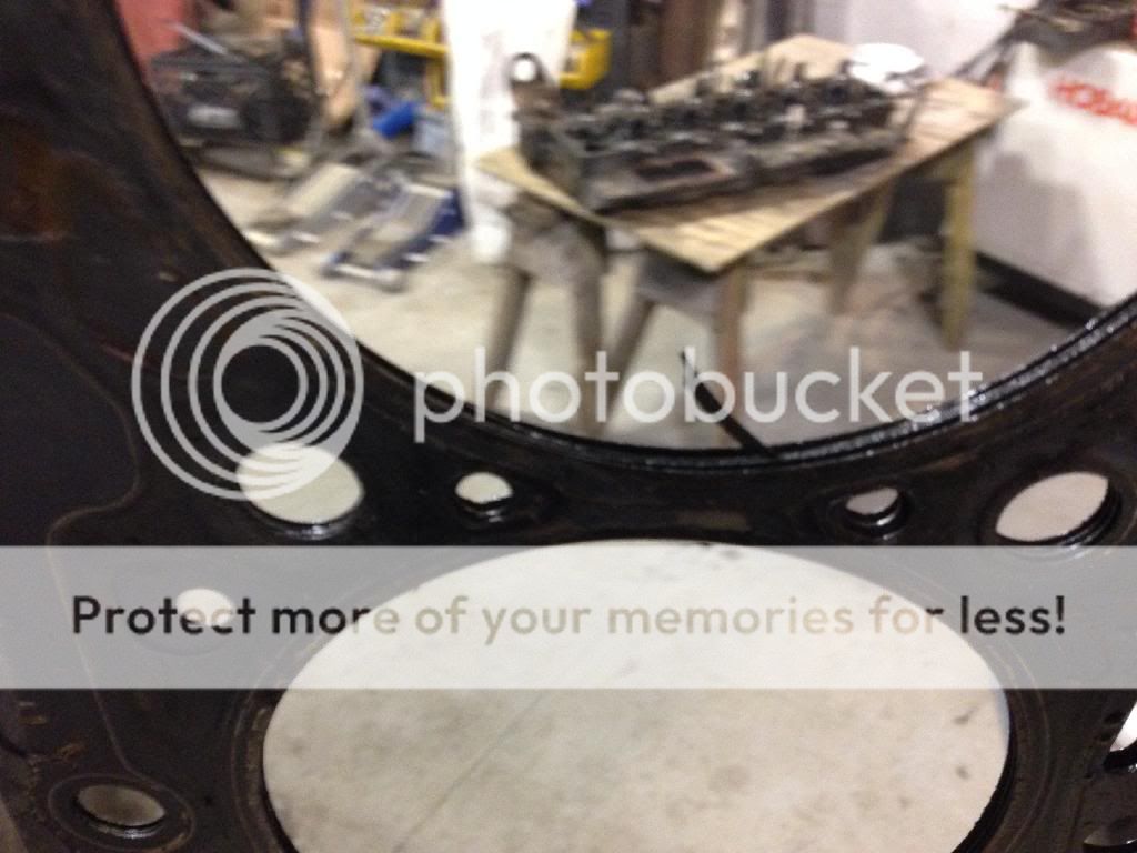

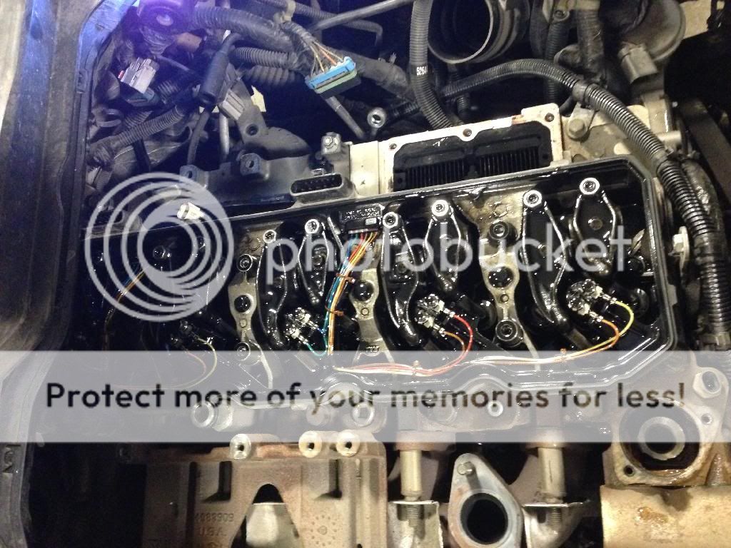

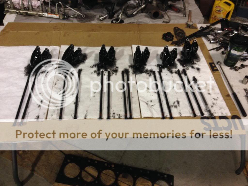

#82 ·
The head was checked, was not decked. everything checked out square and true.
heres a few more pics.
those are just a few.
I do have a question, what gets done with the coolant line from block to turbo?
I know where the 2 coolant lines plug but am unsure what gets done with this one.
thanks
Chad

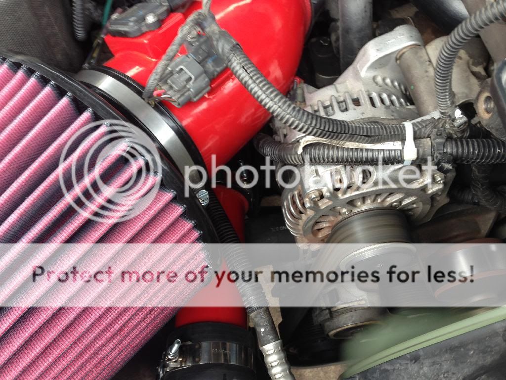

#89 ·
Glad you got it finished. Obviously you figured out the coolant plugs on the head and the side of the block. I want to see your hot side intercooler pipe and how it's attached to the turbo. I was supposed to get the welded v band with 90 but didn't
Sent from AutoGuide.com App

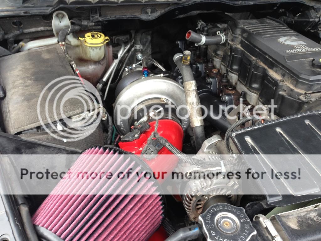

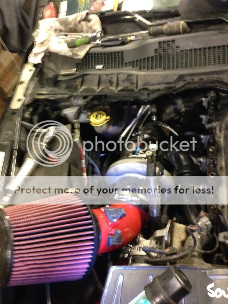

#90 ·
My ic pipe is only 10" long what a tight fit.
Here is a pic as I started putting on the filter I have to take some of the finished. I just want to get going lol.
Chad
