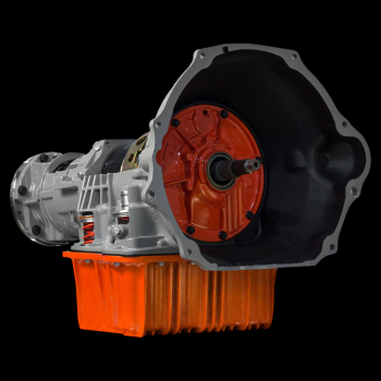

My stock transmission is on it's way out, I sent it on the path to its grave. It's got a bucky surge in low rpm 2nd gear at 10mph. I contacted the tech who would do the work on my truck. I requested a repair plus towing upgrades for the goal of towing rv/stock trailers, plus daily driving.
My tech consulted with a trusted transmission peer. He suggested Sun Coast. After checking parts cost he asked if I wanted a rebuild 1900 + 2500 labor or for him to drop in a whole unit. So, I'm on the fence. A drop in unit or repair/rebuild?
Second question, if replacing, I see these two that look to fit my needs, but slight difference from the valve body option and torque convertor. Which unit would you pick and why?
Category 1 <450HP
or
Guardian HD?
This is the big transmission work I expected, truck is an 06 w 157k. The goal is longevity and towing/hauling thst comes up. I'm fixing to move out to property to start the next chapter of life.
