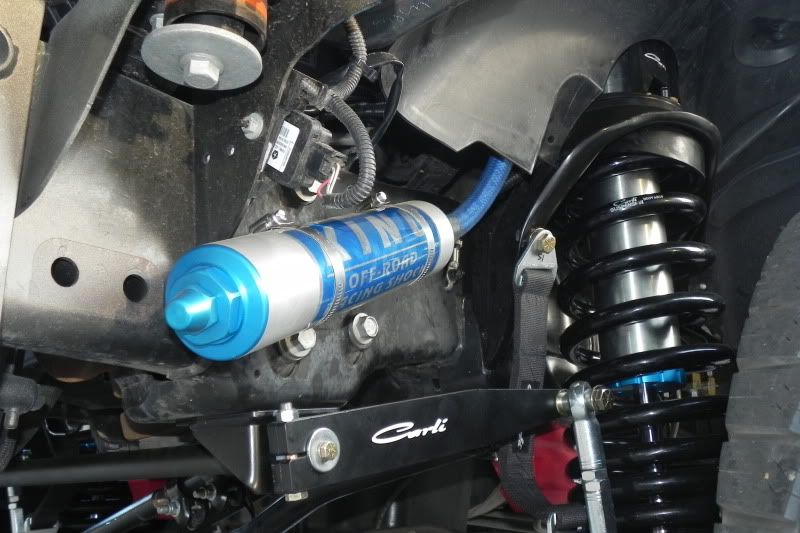

The towers are different than standard fab towers. You'll see in the one picture that the shock bolt hole has been moved forward in order to give the shock enough room to swing back for the short arms. This is not needed for a radius arm system as the shock movement has much less swing even with the longer travel.

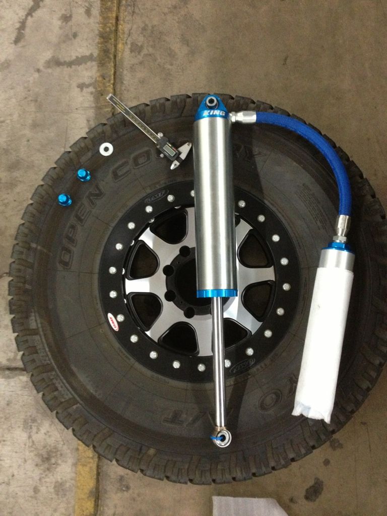

When I asked Sage how much further forward the bolt hole was moved he just smiled and changed the subject...ha
The holes are drilled out to 4.5" which is the same size we use on a 3.0" shock

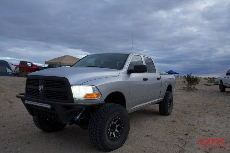

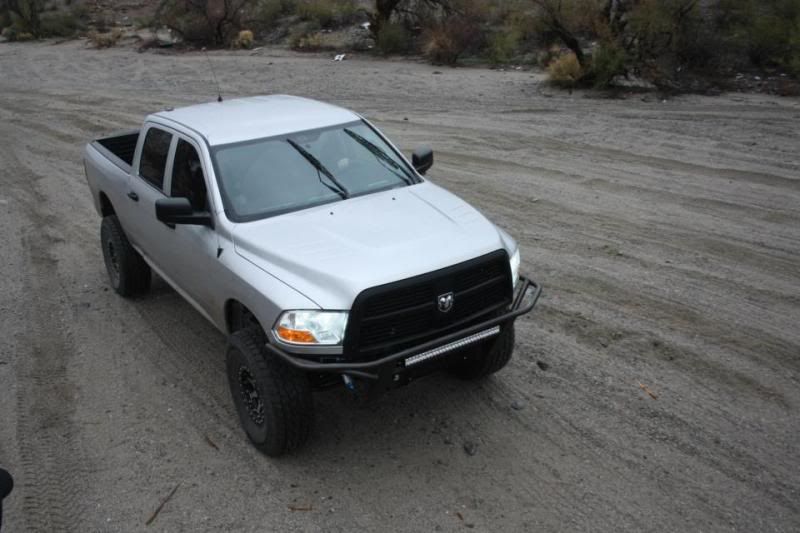

I was a big supporter of long arms as I knew they always yielded the best ride quality and performance but I must say it rides very nice and hard to beat out in the desert.
The Blisteins out in the dirt felt great but as the got closer to full bump the ramp up. These just move much more fluidly over the rough terrain and there was hardly any jarring in the cab.
The bumper horns are from our buddy at PatonFab and I worked with the tube to get it the way I liked it.
