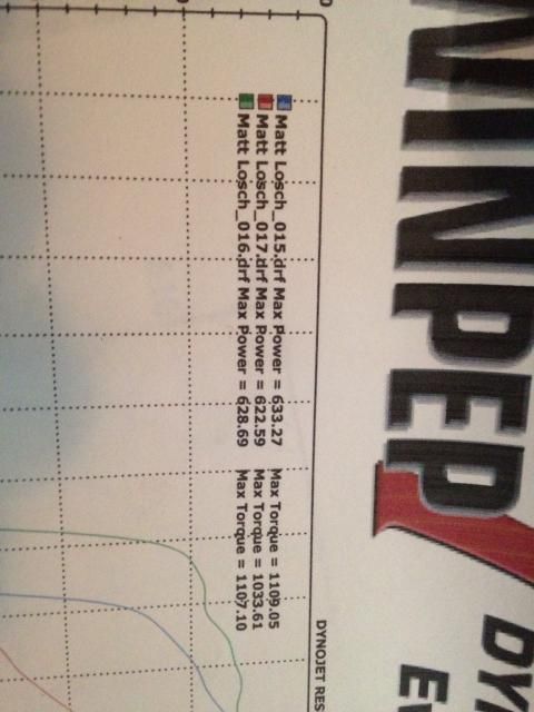

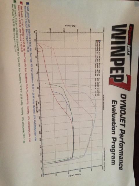

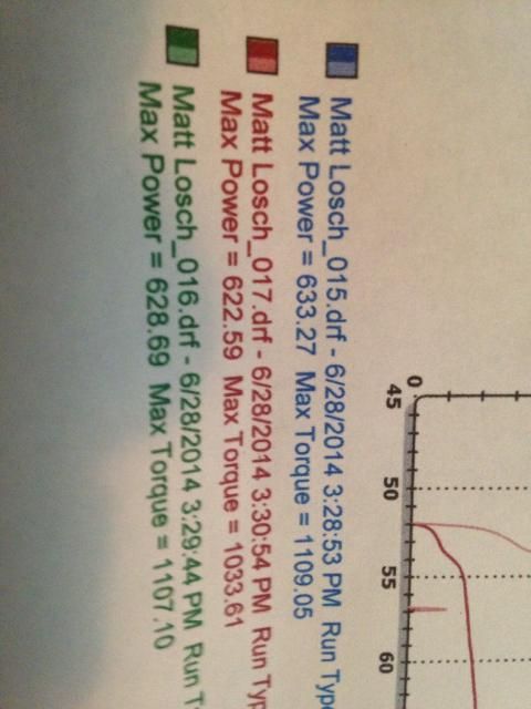

Well I've dynod my truck twice, two diff dynos and same horsepower on both. Even had les drive on one of them to see if it was maybe just me.. I feel my numbers are lower than they should be..
It's made 639 1140 twice +/- 10hp ..

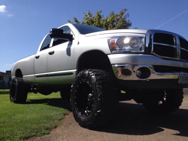

Truck
2006 cummins 3500 cclb
G56 w/ southbend 3600
Efi live via les at silverbullet tuning
Airdog165 w/ 1/2" lines to both cp3s
Ppe dual fuelers w/ dmax top pump
II dual feed line
Steedspeed 2nd gen style
Borgwarner s366
5" exhaust
5" intake to afe filter
150hp injectors
Springs
Studs
Pushrods
3angle valve grind
03-04 pistons
Etc...

Rail is perfect, doesn't drop at all, injectors are extrude hone 150hp with about 10k on them and the new bodies, no boost leaks, tires..... Yes lol 37-13.5-20 on a 20x12
Does running bigger tires cause lower hp numbers on a dyno? I have no clue

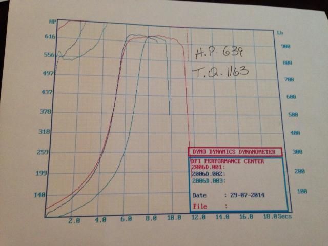

It's smokey down low then cleans up on top end, one was a mobile Dyno and today was a loaded Dyno but I may have been blowing thru the brakes.. Dyno graphs are smooth and look good, just low. Two completely diff dynos and exactly the same hp just seems weird unless both aren't loading on top end I guess.. If u have Instagram I have a video of my pull mattlosch17

First Dyno was Jefferson state mobile Dyno at the Nhrda here in Woodburn Oregon, where les drove my truck on the Dyno.. Second was at DFI performance here in Oregon on a "loaded" Dyno do not know the brand think dynojet? Was super old inground Dyno..
The turbo is a s366? Three years old purchased from manning Motorsports don't remember all the specs on it but believe its a 66/73 .91 t4
#26 ·
So first Dyno was at the Nhrda and was a dynojet
Second Dyno was a Dyno dynamics

Since all the pulls finish at the same peak HP I don't think its dyno loading. What rail pressure and duration is he commanding? I also think knowing EGT's would help. So far its all looking like it just wants more fuel. I know you said you trusted the 150's but maybe they are on the small side of 150?
And dyno's that don't show RPM are super frustrating to me. :banghead:
