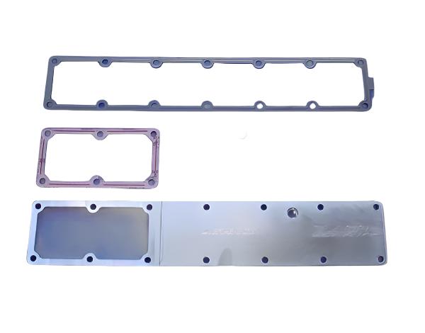

I've seen videos about the grid heater bolt dropping into the engine and instantly needing a rebuild.
Can I just remove it? I see banks sells a kit to replace it. But do I need a replacement kit?
Thanks.
You can simply unhook the grid heater wire from the relay for free. The plate isn't really necessary.
#5 ·
You can replace it for peace of mind and for more air flow. I have seen some customers tack weld it, lock tite it and more. really up to you on what you would like to do. If you do decide to replace it, i highly recommend Glacier Diesel Power's air boss grid heater plate.
good to know the problem. So basically the bolt melts off from overheating and arching due to the solenoid sticking on causing them to run to long.
Fully removing it is an option, but you need to pull the fuel rail to do it. Not to bad, but not quick and easy either. Newer truck could generate codes, apparently it’s something to do with remote start.
Or, just leave it all in place and disable it. Simply unplug the power lead going from the passenger side battery to the solenoid. That it. The truck still calls for grid heaters when it think it’s needs it, but they never power up. Then, should you ever be in a situation where you need/want grid heater you just plug it back in. (assuming your “bolt” is still tight and safe, check it from outside). This is I would and did do.
Banks is marketing this issue super hard to sell you a $1000+ intake setup. But it’s all totally not necessary or beneficial for 99% of the truck out there. The internet is full (specifically less knowledgeable Facebook channels) of people seeking confirmation bias for the money they already spent on Banks horns.
If you want the grids functional and 100% safe, and don’t kind spending money, GDP makes a sweet grid heater that replaced the TV flapper.

#35 ·
I would personally go this if I really wanted a grid heater. This goes in the place of the Throttle valve flapper on the inlet side of the factory horn. As well and cut out the factory grid heater.
#36 ·
Should also mention that if he isn't tuned then this will throw a check engine light and remote start won't work
Removing that throttle valve or even unplugging it when emissions are intact will throw a cel unless you are tuned with that code removed
There is a spacer with a dih4 coil that can be put in place inbetween the intake manifold and throttle valve that black market performance makes too
