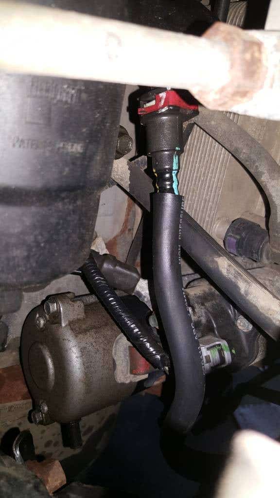

On my 2010, the fuel supply line going into the filter housing has one of those QC quick connect fittings. When I was removing it, the little retaining clip broke. I cant seem to find that clip on any parts diagrams or searches. I found a picture from another thread on the forum that shows what I am talking about. The Red clip in the picture below. Just need a way to secure it onto the housing.
Borrowed image from member Long-Horn

You may have to take the part off and show it to the parts counter guy at the Dodge dealer so he can find it.
#5 ·
I was unable to find replacement, dealer didn't know either. My semi-permanent solution was to safety-wire around the plastic fitting then double strand twist to the housing as an anchor point. It is working good for me, but ideally I would like to get new fitting eventually.

I went to oriellys this morning and picked up Dorman Part # 800-040 and it’s the identical part. It was $12 for 2 which is kind of pricy but it’ll do I guess. Hopefully this helps someone else.
NOTE: Do NOT buy the Dorman part #800-041 it is too big!
#14 ·
Oh I see that you just needed the clip. I needed the whole quick connect connector that is molded into the line as the yellow O-ring inside the connector has gone bad
