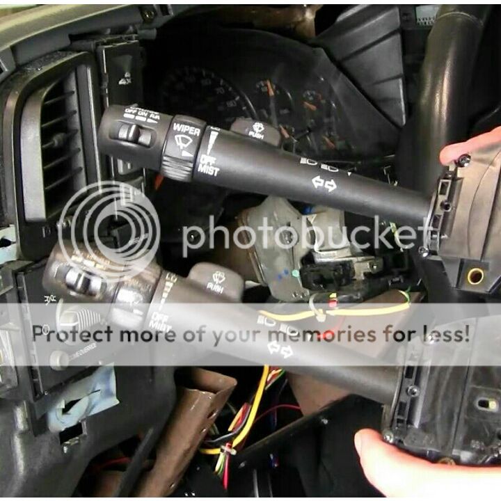

Nah man, my truck was built in nov of 89, non-ic, LE high option package as far as I can tell, ive got the chome everywhere, all the bells and whistles except power mirrors. My left stalk contols my wipers (intermittent wipers) my turn signals and my high and low beams. But it also has 90s GM style cruise contol on it as well, but my speedometer is electronic, not the cable driven style
My stalk is alot like the top one in this picture, aside from different styling. But its OFF then the next spot is ON and then the R/A is a switch that you push into and thats what sets the cruise. My 88 318 w150 had the exact same stalk, same colors, same style, even contolled the same stuff, did I maybe get a mid year change and get the cruise stalk simply because dodge was using what was left of them before they moved to the wheel or...? I know Chrysler especially loves mid year changes and stupid crap like that. Not shooting anyone down here or trying to be a know it all, this has just got me stumped.
My first inclination is that somebody swapped out the columns or something like that... Too bad no one else with a 90 or stalk type controls has chimed. The electric speedo is correct for any 90 all of which were built in 89 or possibly into the very early months of 1990.:thumbsup:
