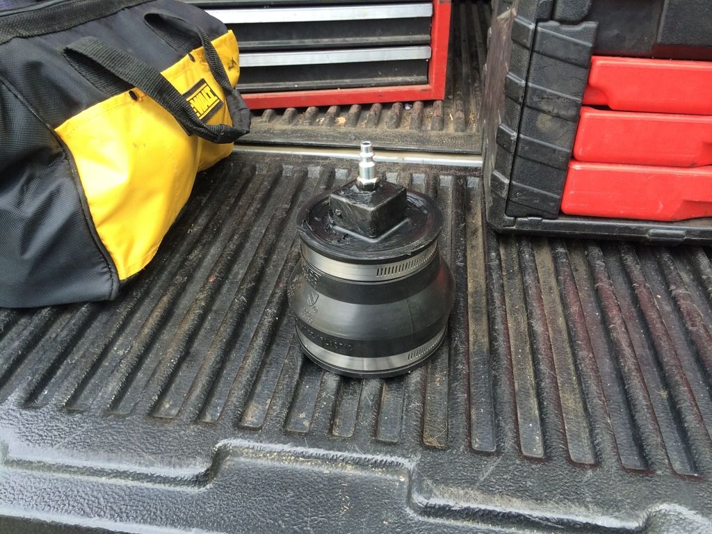

How are you testing the system first of all? Did you build a tester such as this to fit over the turbo?
Run it up to around 20 psi, then spray (with soapy water) all the boots on the piping, around the intake horn, and the intake manifold plate. Set the valve on your air compressor for the 20 psi, then just leave the compressor on and hooked up to it while you are searching for leaks. There may be some air that will leak past your valves, but the compressor should be able to easily keep up with this while you do your checking.

I am a plumber so I made my own air setup every one of my boots was leaking on my air test but I tighten them up and can still hear air rushing out of somewhere but I can't find it
