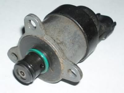

At the bottom of the picture you'll see the fuel control actuator (FCA) which has the black colored electrical connector attached to it. Also you will see the HP fitting that the fuel line running to the rail is attached to. First remove the FCA, leave the HP fitting in place for now. The FCA will look like this. Take note on how deep that silver cap with the hole is set into the FCA, it will need to go back in to about the same depth.

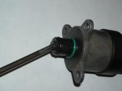

Start with an extremely clean work place. Using a long Grabber sheet rock screw, thread the first thread or 2 into the hole in the end of the FCA, just to the point where the screw has a grip on the cap in the end of the FCA. Take the head of the screw and clap it in a vice and LIGHTLY tap on the FCA away from the vice to remove the end cap. It is a very snug fit. The original article says to pry it out, I found this very difficult and was worried about damaging the end cap. I found this method with the screw and vice to be much easier and less harsh on the FCA. (Works like a puller)
DO NOT DO IT THIS WAY.
Use the “screw in vice” method like this.

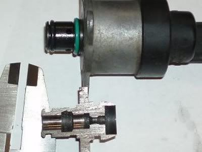

Carefully remove the spring and lightly tap the fca on the table to help slide the metering valve out. (Use extreme caution when handling the metering valve. If it is bent or even scratched it can stick will be useless.) I was not able to tap the metering valve out, it is to tight of a fit. I use a small pic and was able to hook into one of the two small holes at the bottom of the metering valve after you have removed the spring. Once hooked into one of the holes, pull firmly, but gently, until the metering valve comes out. The valve is made of soft steel and will crush or deform fairly easily, treat it gently.
Once all is out you will have this.

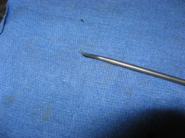

Use a Pic like this to help get the valve out. Look for the two small holes at the bottom of the valve

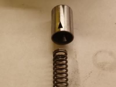

All the fuel that is allowed to enter the plungers must first make it through these two tiny triangular holes in this valve.
Each triangle is 0.110" high, and 0.068" wide, for a total area of 0.00748 square inches between the two. This is equivalent to a single hole with a diameter of 0.097".
By enlarging these triangles more fuel will be able to get to the plungers. This is the smallest restriction from the inlet of the CP3 all the way into the plunger chamber.
We've tried various shapes which allow more or less flow at each duty cycle (position) of the valve and the one that works the best also happens to be the easiest to machine.

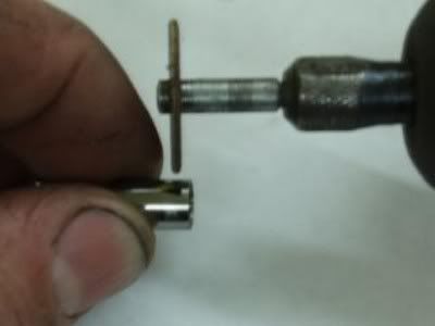

A simple dremel tool cut-off wheel can be used to perform a simple slice into the triangle.
**It is extremely important that you do not modify the tip of the triangle. The tip is crucial to the valves ability to stop and regulate fuel at small flowrates (idling, cruising, etc.)**
Use some gloves or something soft for protection. I don't want to hear complaints that you cut your finger. Don't chuck it up in a vice because you'll damage the valve. BE CAREFUL!!! OK, you can put it into a vice, which makes for a much easier and better job cutting the notches, BUT you do need to do it carefully!!! I used rubber jaws in my vice, and I clamped the valve into the vice perpendicular to the jaws, so not the crush the round portion of the valve. Also clamp it VERY lightly, just tight enough to hold it for the dremel. (Which is not very tight) If you find this to risky, then just hold it with your fingers. But both ways have a measure of risk.

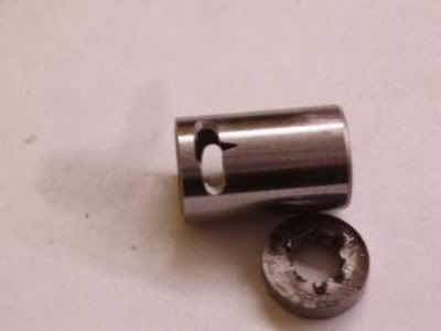

Here's an example of a cut valve.
You'll need to spend a LOT of time polishing the cut edges both inside and outside with some very fine sand paper. (I used 2500 grit) The valve will need to freely slide in and out of the housing without force. If you get in a hurry and force a valve into the housing with a burr of any kind it will scratch the housing and be JUNK. Throw it away and start over. (AKA, go buy a new FCA.) The valve will actually go back into the FCA rather hard (just like when it came out) but when it is in it’s working position it will slide back and forth (about ¼”) smooth as silk. If it does not, then you need to smooth it out some more. You may also need to smooth the inside of the FCA channel as well. This is not an area where you want to leave any rough edges. THIS CAN NOT BE STRESSED ENOUGH. NO BURRS OR ROUGH EDGES OF ANY KIND!

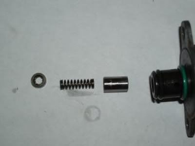

Now take a look at the spring and end cap that you pried out. Remember they stack like this:
You can enlarge the center hole in the end cap, but there's really no use going bigger than 0.130" since that is the I.D. of the spring. Fuel has to travel down the center of the spring on its way out of the FCA.
Again, I cannot stress deburring all edges with sandpaper and cleanliness enough. You don't have the luxury of a filter to catch your mistakes. What you leave behind goes directly into the pump plungers and then into your $350 a piece injectors.
Insert the valve, spring and press the end cap back into place and you're finished modifying your FCA. The end cap goes back in so that it is just below the end of the FCA, just enough you can feel a slight lip.

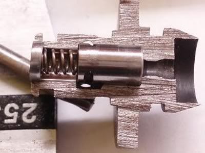

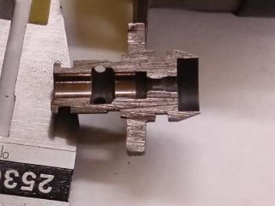

Here is the housing cut open.

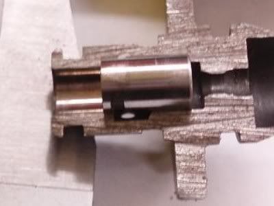

Here is a closer view. Look at the first darkened region (left to right). You'll notice two holes. There are four holes total and this is where the fuel enters this valve.

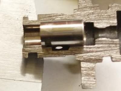

Here is a picture with the valve in place positioned to delver NO FUEL!
Here is a picture with the valve in place to deliver FULL FUEL FLOW!
This final picture shows all three parts in place!

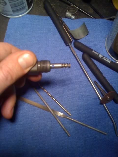

Now on to the High Pressure output fitting in the CP3.
If still attached, remove the HP fuel line to the rail, then remove the HP fitting from the CP3.
There is a check ball that might remain inside the CP3 after you remove the fitting. (at the end of the spring) You need to take it out, and set it aside for re-install later. It is dark in color and NOT magnetic.
Once you have the HP fitting out there are two holes you are going to en-large. One hole is inline with the fitting, and one hole is perpendicular to the fitting.
Enlarge this hole to .125 or 1/8 inch
Enlarge this hole to .140 or 9/64 inch, push all the way through to the other hole.
You could make these holes larger, but this was as big as I felt comfortable with, and still maintain the integrity of the fitting. Also you have to consider that these holes will still be larger than the smallest hole in the system, so they should not need to be much bigger.
After you have enlarged the holes, put a very small dab of grease on the end of the spring and stick the check ball onto it, then carefully reinsert the valve back into the CP3. You must make sure that the ball goes all the way in with the spring on top of it. If you bind up or the ball falls off, stop and try again. (took me three tries.) I recommend a towel under the truck to catch the ball if you drop it, also it helps if you use a small mirror to help you guide the HP fitting, with the ball, into the hole. Make sure all of this is very clean when reassembling. DO NOT CRANK THE TRUCK IF THIS CHECK BALL IS NOT IN PLACE.

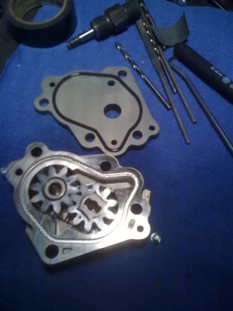

You will notice that I did not include the section about modifying the external pump on the CP3, even though it was done in the original Relentless article. I actually did take apart the external pump on my CP3, here is the picture from it.
Both of the holes that you would modify on the 6.7 pump are already bigger than was recommended in the relentless article. So I put mine back together and left it be. I am quite certain there are mods that could be done to that pump, but I doubt they are DIY at home type.
