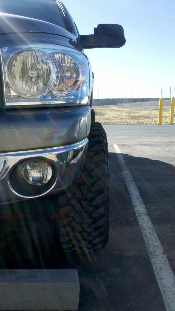

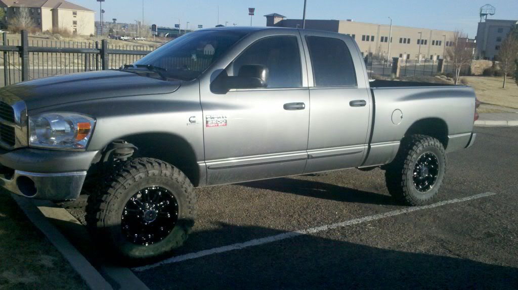

Hey man I have the XD Hoss wheels 18x9 with the -12 offset. I have Toyo MT's 35x1250x18 with a 2 inch leveling kit my tires do rub on not even a full turn of the steering wheel on the body and fender. My tires stick out of the wheel well around 2.5-3 inches but with the toyos they are actually around 13 inches wide. Your truck stock with 285/65's should not rub at all but do you want them to stick out with that size tire it might look kinda of funny sticking out that wide you might be better off with the +18 that will only push it out about an inch further than stock apposed to 2.5 with the -12. Then again its all about preference what do you like. Here is a pic so you can see how far they stick out. I am going to a +18 in the next day or 2 if you want to wait I will post again after I get them put on. I will also be putting on a 4 inch lift as soon as it gets in. Hope this helps.

Thanks for the info and pic Rydogg. I was thinking that they may stick out a little far for that size of tire. I will probably just pass on the used set of -12mm offset ones I found and get the 18mm.
