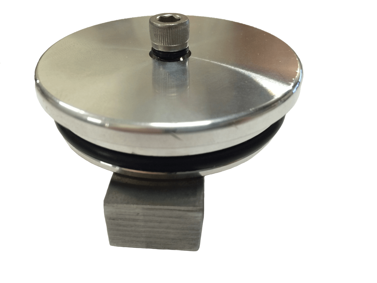

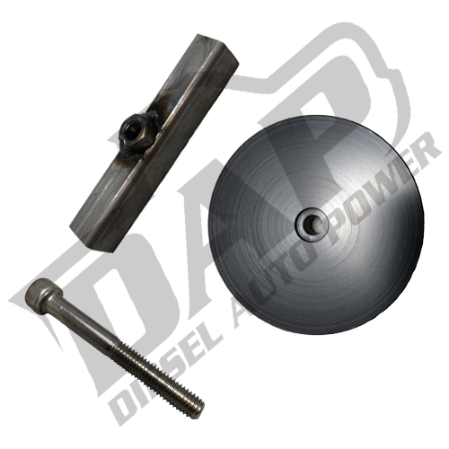

Nice work, but why go through the effort and take the time when there are a BUNCH of readily available billet freeze plugs that seal with a rubber O-ring (similar to the way the OE block heater works). Below is just a few examples, but there are a bunch out there and the prices aren't terrible.

I suspect you're gonna have issues sealing a rigid aluminum plug into an iron block using an interference fit (vice the rubber O-ring all the linked ones use).
Aluminum and cast iron expand & contract at different rates, so there will be some relative motion between them. Relative motion while force is applied (from the coolant system pressure) may cause them to pop out or leak (or crack the aluminum as aluminum expands faster than cast iron).
Whatever happens (good or bad) , please update this thread to let us know how it worked out for you.
