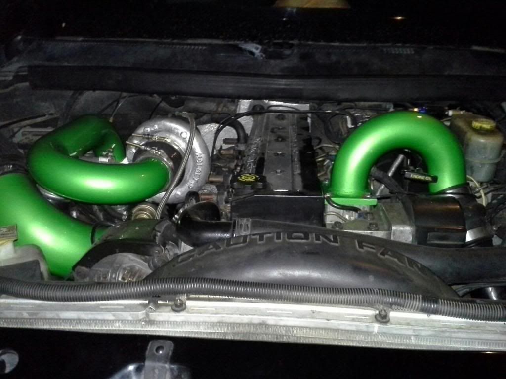

Is anyone running an s475 with their hx35?
340 Posts
Where did you get your parts from? You running springs&rods with that?
1,237 Posts
Springs are a good idea for compounds. Source auto.biz has a lot of single parts to piece together a kit
74 Posts
no springs, I have gotten away with stock head gasket headstuds and I got parts from source, Diesel auto power, silicone intakes etc. I built them myself so I did all the piping fab work and brackets. I also ported and polished my manifold and turbo exhaust inlet to bring down drive pressure and get the turbo spinning quicker.

That's looks good man. Thanks for the input
74 Posts
ya it is a good set up for towing.. performance it is moderate set. but still way fun!!!

ya I did built them myself, building another set for a guy 62 over s475
74 Posts
ya I'm just rocking a little Lincoln 110, I would love a TIG for better looking welds and/or aluminum welding but.... I haven't broke down to buy one yet
6,927 Posts
Just make sure you can clean the inside of the pipe. I did that with my first cold pipe I made and had to use 3.5" pipe to be able to get my hand inside to clean it up.
74 Posts
yes for sure!! ain't nobody got time for wire and slag into turbos!!! ^^^^
