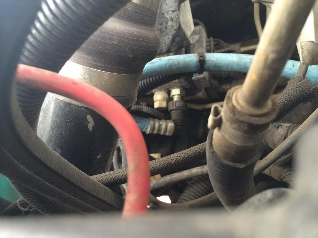

Thanks! Very elementary question....what's the best way to check to see if I'm getting fuel? Should I crack the line at the fuel filter housing?
I would crack it right at the VP. I have an airdog and bypass the stock fuel filter so my lines are blue but its in the same place. It is easier to get to in my opinion then at the fuel filter. The second picture shows it better, where the blue quick connect is on the drivers side.
