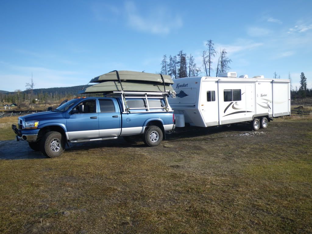

If you have a levelling kit and tow anything heavy you WILL need air bags or something to stop it from squatting, no way around it.
If not it'll look pretty stupid and you'll be blinding people going the other way at night.
We pack lotsa crap when we camp, 2 boats, 2 motors, 2 sets of anchors, etc etc including 60 gallons of water in the back, then we have a trailer with a 1400 pound tongue weight, this pic I have probly 70-80psi in my Pac Brake air bags
