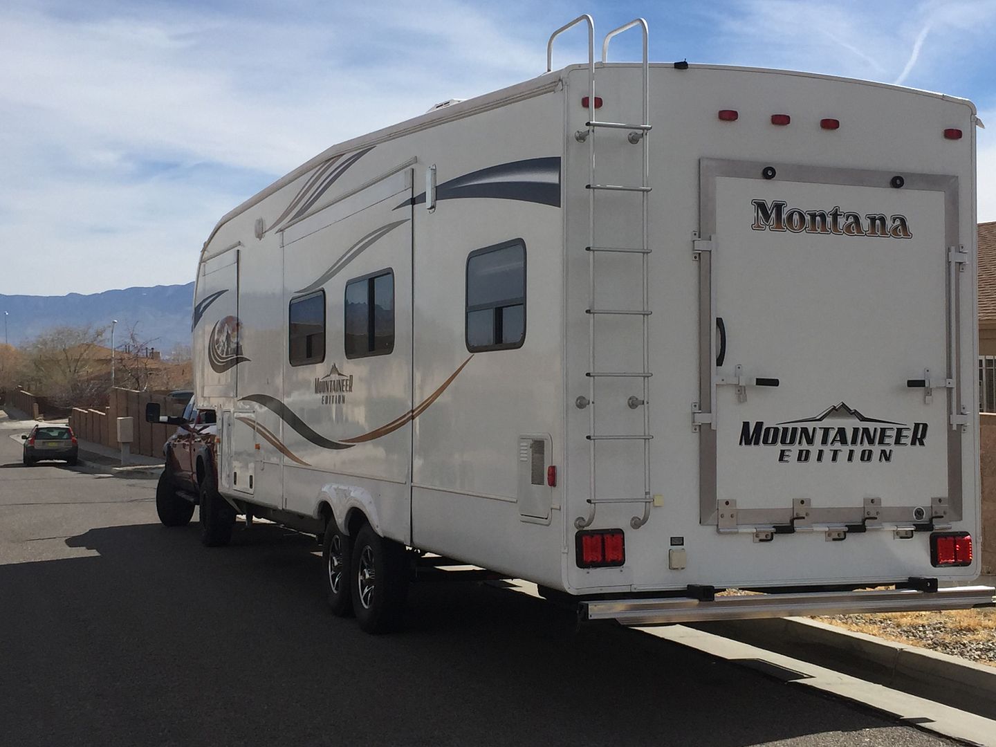

I'll make no comments on the truck size, 2500/3500. That's your decision, go with what makes *you* happy, not the forum weight police. Mines the short bed, I tow a 14k loaded RV. I use the Anderson hitch, never had a problem with clearance issues. A lot depends on your hitch and camper, some older RVs have square lower corners on the front cap making tight turns iffy, always use a spotter if that's the case. My RV is a 2002 without the round lower but not the big square fronts I have seen on some. The Anderson sets the ball back a few inches, enough to make a huge difference. A regular 5th wheel hitch, I suspect would put the camper nose way too close to the rear truck window. In that, I have no experience as I've always had the Anderson.
