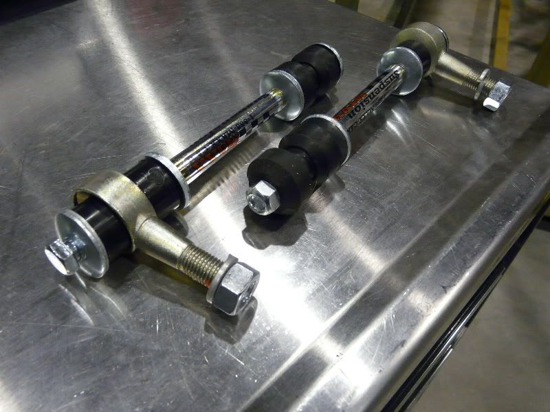

Also installed a set of MAXX links sway bar links, from Summit racing, about $80.

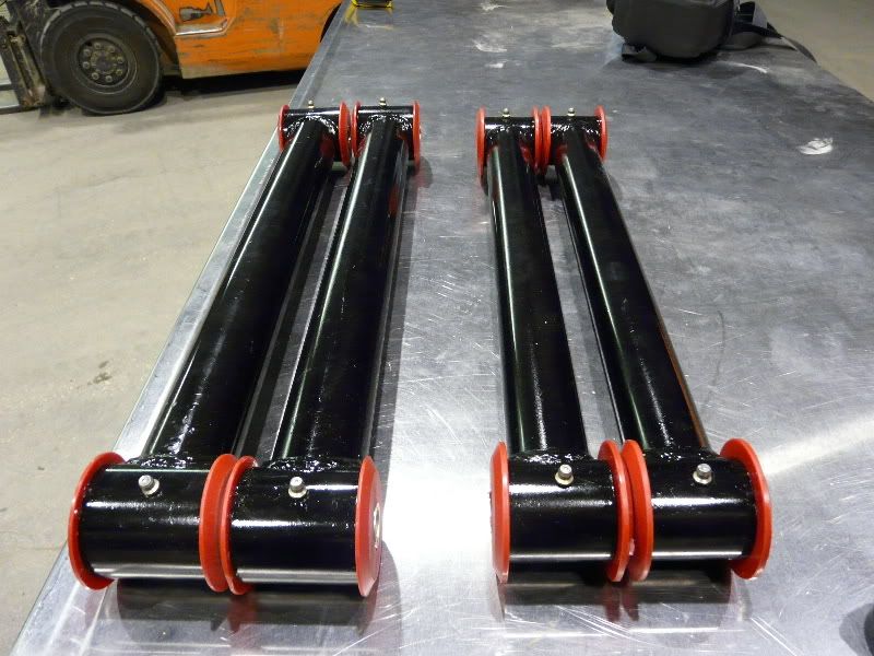

Top Gunz Customs control arms off ebay. I was surprised at the quality of these units for the low price. I would definitely recommend.
Maxx sway bar links. Quality units.

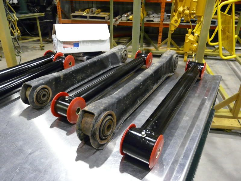

Stock

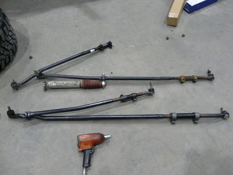

Stock 'y' steering
Top Gunz control arms compared to stock
Both steering systems compared

NOTE: The 't' steeing upgrade does not have provisions for use of a steering stabilizer. As such, I have not yet installed mine and will be making a clamp bracket to adapt it to the tie rod. Currently, with no stabilizer, 35" mud tires and offset 20" wheels the truck still drives MUCH better than before. I suspect it will improve still with the addition of a stabilizer.
I recommend changing the cam bolts and washers when installing new control arms. The indexing flat on one of the washers was rounded out, and as a result, did not allow for proper caster adjustment. Bolts are available at the dealer for a reasonable price.
