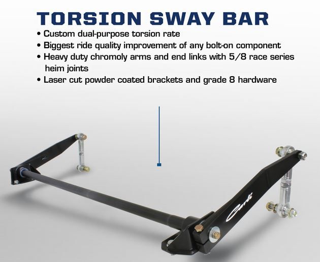

Bars are different and a lot of people are happy with both. Our view was that you're putting a TSB on the truck because you don't want to get out and disconnect it. You want a bar that will engage only enough torsional rate to keep the tires planted and not allow excessive body roll. Our bar does this in every situation. We elected to upgrade the bar to 5/8" heat treated, Chromoly FK Bearing heims for longevity and durability rather than go the disconnect route because we wanted a bar that would do all of the above that you wouldn't need to worry about disconnecting. Not saying we did it the right or wrong way, just that we built the bar that we wanted to run.

I have never personally seen a carli bar. Thuren has a bend in the ends to help with tire clearance. Im pretty sure carli is straight at the ends. I know ive never heard about tire rub on a carli swaybar. So what is different from a carli bar to a thuren bar? In reference to how the carli bar clears tires.

Our outter links run tight to the frame then have a bend to kick them out and meet at the end link, they're not straight and are bent for tire clearance.

No problem. You can actually see the bend to which i was referring on the picture from the website... :thumbsup:
