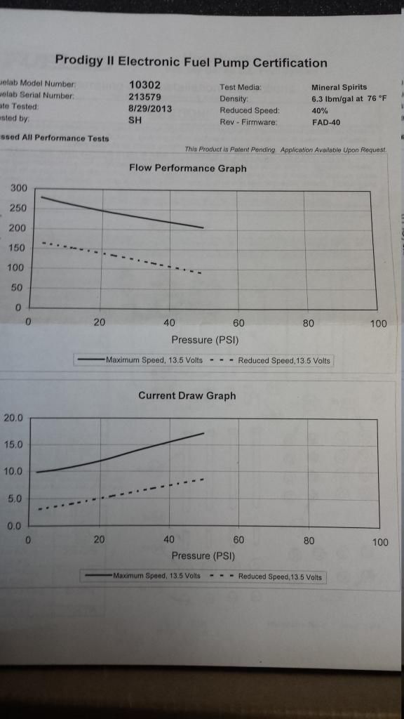

No, but their reputation precedes them. They are a brushless motor wet motor with a board inside that controls draw to keep a very consistent fuel pressure. I talked to the guy at Fuelab, and he told me I should never see a drop in fuel pressure...never. So, we'll see about that. Im skeptical, but I will test that theory as soon as I get the tranny in! Plus they have a third pole on the motor that will double the amperage draw if necessary. Its not something you want to leave on all the time, because from what I understand it puts the motor in to max amperage draw mode and it will get hot. Its something that is for competition use. I may hook up an Aux. switch to it down the road...

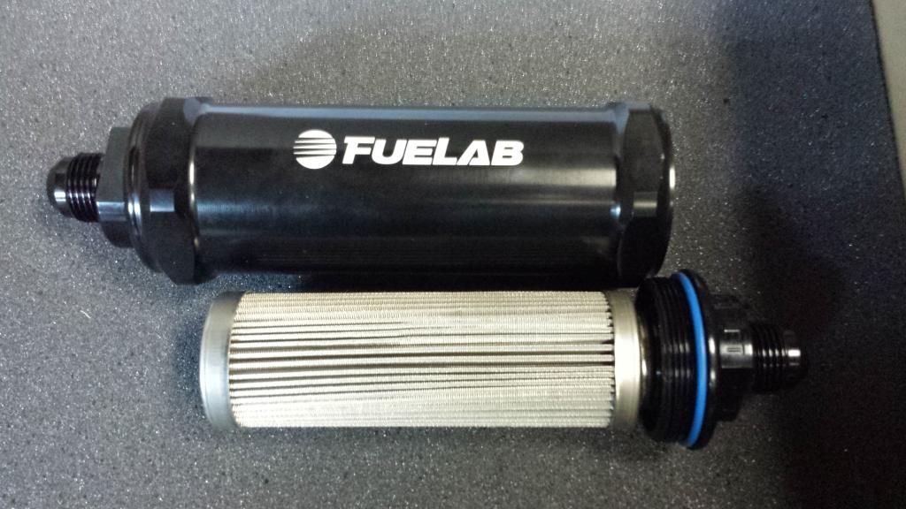

75mic prefilter
Printout that comes with the pump
