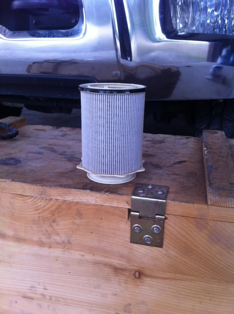

Decided to change my factory filter at the engine today. I currently had 10,000 miles on it (pic) I use to change this at every 6k previous to my addition of the extra filter and water seperator and it would be very dirty like charcoal or almost black after just 6k miles
I added the baldwin BF1212 water seperator and the CAT 1R-0750 filter and the first change i did at 5,000 miles and it was very clean, so i pushed it out to 10,000 miles and it is still pretty clean IMO. I may run it out to 15-20k this time around
For those on the fence about adding extra filtration this is a must as the factory fuel filter set up and the crap fuel we get at the pump is less than stellar
Just wanted to share
after 10 k
my filter set-up

Looks better than mine did lol. No extra filtration. I am running the nanonet filters. First pic 12,000 miles second 10,000 miles.
Auto part Cylinder Filter
Grille Automotive exterior Bumper Auto part Technology

$130 total into it with the cost of filters. thats building it myself, the reason i didn't go airdog/fass was because i never plan on any hp increase that would require that. my goal since day 1 with this truck is just reliability.
i went with a good filtration set up for both fuel and oil and haven't looked back

thats pretty dirty, i would def. throw something extra on there whatever your flavor ended up being
