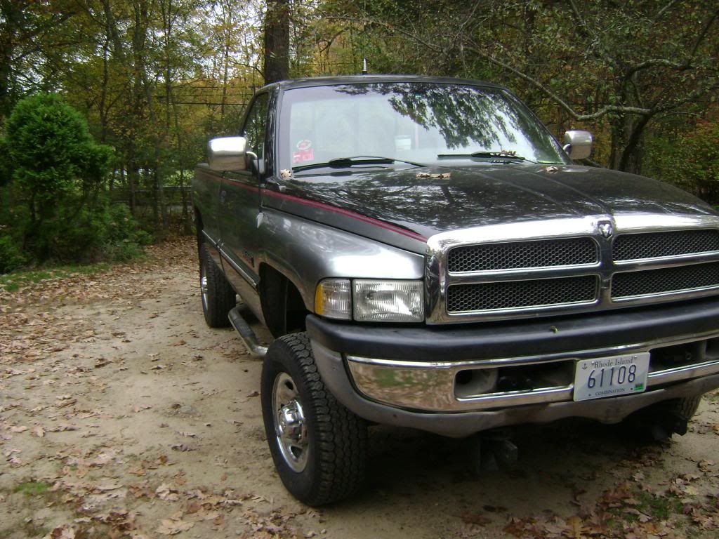

Nice to see another truck with colors like mine, I've only seen a handful with this exact paint job. Here's mine when I first brought it home.
Yeah i love the color, when i respray it ill try to keep it the same. Ive seen 2 others besides mine and yours
