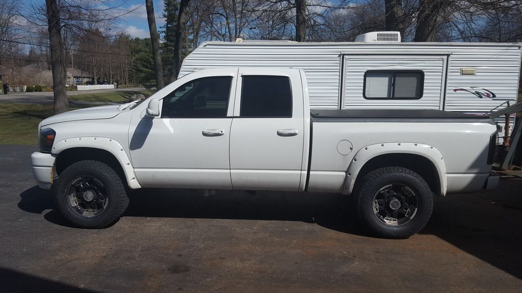

Here's mine! (work in progress actually so don't mind the grill or hood lol) Coming from being slightly lifted on 38.5s. Loving this look way more. Did a reverse level, removed the overload leaf and now rides so good. Love how smooth the Nittos are. Like driving a half ton almost!

Looks good! What are you doing with the grille?
When you removed the overload, did you put any of the spacers back in on the bottom? I reverse leveled mine too but have been debating on removing the overload to improve the ride a little more.

I had my over load and spacers out for awhile. It rode great! The only problem is when I needed to use my truck as a truck. I put 500 pounds in the bed and it was useless to say the least! If you're going to go that route and use it as a truck still get air bags.
I got a new set of tires so here's mine again. 325/60R18 reverse leveled with no over loads or spacers

I just put one spacer back in. Sits perfectly level, I am getting a mesh grill insert for the truck. Need to find a roll pan then I will go get all my stuff painted to match!
