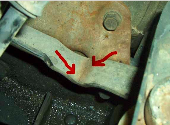

Hey. I have been searching a bit and found some stuff, but i'm going to ask anyway to clarify. My steering bracket has formed a crack near the bolt. The frame has also developed a crack behind the radiator support on the top edge. Same as in this picture from DTR:
Tomorrow I am going to remove the steering box and bracket and weld it up. I am also going to weld the frame back up. Any advice on doing this?, i've never done framework before. Also, I am aware that this is a somewhat temporary solution. What can I do to prevent this from happening in the future? If anyone has dealt with this and has any tips it would be greatly appreciated.

If you have a way to do it I would weld it and then try to add another piece of steel to the bad area to help make it stronger.
