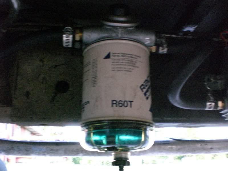

Well everyone, I finally had the weather last sunday to put our custom fuel system on the truck. Went pretty smooth.
SRE Custom Fuel System:
Vulcan Draw Straw
3/8 Marine Diesel Fuel Line
Racor 460R Fuel Filter Water Separator(60gph 10micron, 90gph 15micron filter cartridge available(490R)
Holley Black Fuel Pump, 120gph @ 9psi (rated)
Vulcan Full Flow Fitting.
Price: roughly $210
Here are some (sorry, a bit dark) pics of it installed:
The Filter:
The Pump:
Both:
What you can see from the outside:
All in all, it took about 5 hrs, including lunch :popcorn:
RESULTS:
At first, pressure was 15psi, dropped to 4 under WOT, but as the air got worked out of the filter, as my brother drove to work this morning, he made a drastic discovery, the guage was pegged over past 15, dropping 1/2 a psi under WOT! :woot:
Im going to turn the pump pressure down, it has the flow, no reason to have all that pressure, its just going to wear out the springs in the pump that hold the valve shut in there when its under 15 psi, my worries: they wont close, and it will drain the fuel from the pump when it needs it, but maybe thats just me.
- Neil

Here are some clearer pics:
This thing is allready starting to collect sediment in the bottom of the filter bowl, im rather impressed!
837 Posts
Well like I said, the guage was pegged over, but that pump just died on us, so we picked up a replacement from summit for 80 bucks and its forking great. The last one seized a main bearing and scored the shaft, like it got some sort of debris in the oil groove of the bearing and it just locked up one day, wouldnt even start. If I needed to, I could limp the truck home with minimal IP damage, with the primer button you see on top of the fuel filter, I can pump the system up to 10 psi, and I suppose you could stop every so often and re pump it up.
But anyways, the new pump and spring setup has the guage at an estimated 18 psi at idle and around 14-13 WOT. The thing just flows a ton of fuel.

Yup, took the pigtail off the motor and cut the lift pump end off it and after finding out which wire is the hot and which is the ground, soldered em up, and ran 14g wire back to the pump.
In a year or so, we are going to have to find a new pump setup to support a 700hp 12v that we are building up to put in here... 120gph at 10 psi isnt going to cut it.. Im looking at an aeromotive A1000 or something like that, but needs to hold up to daily driving.
