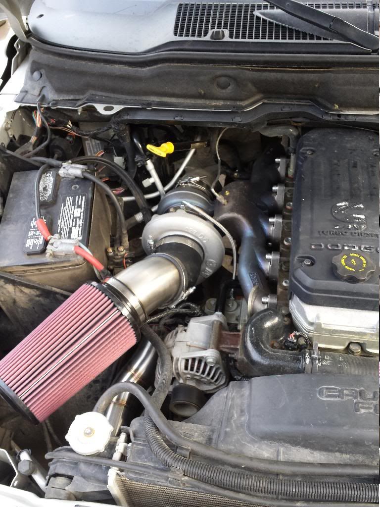

Figured I would start a thread for my build and go over what has been done and will be done. As for the goal, I am seeking a clean DD 750hp. Mods on the truck so far are: FASS 150, II 33% cp3 (JUNK), BBI stage 2 injectors, Anarchy second gen swap kit with stainless diesel manifold and 63/68/.91, 4" exhaust, Edge Insight, autometer boost and fuel (lift) pressure gauges, UDC by Ryan, and an upgraded 48re. I have a set of Hamilton 110lb springs, HD pushrods, and a set of 425's that will be going in shortly as I have been short on time. The parts on my list to get are: Fleece 10mil cp3 (new not reman), I would like to try out a Hamilton 188/220 cam, S475 to add to the 63 and may drop down to a 62 on the secondary depending on spool characteristics after the cam is in and tuning is adjusted accordingly, billet output in the trans and possibly a fat input as well. I am not as concerned on the input at the moment as my trans builder and I would like to see how far we can take my current setup. Thats it for now as its late and I probably missed some things but ill add to it later. Why not a few pics just because.

Im in for information. Im installing same mani and turbo today with intentions on compounding it with a 475 or 480 later down the road.. good luck:thumbsup:
