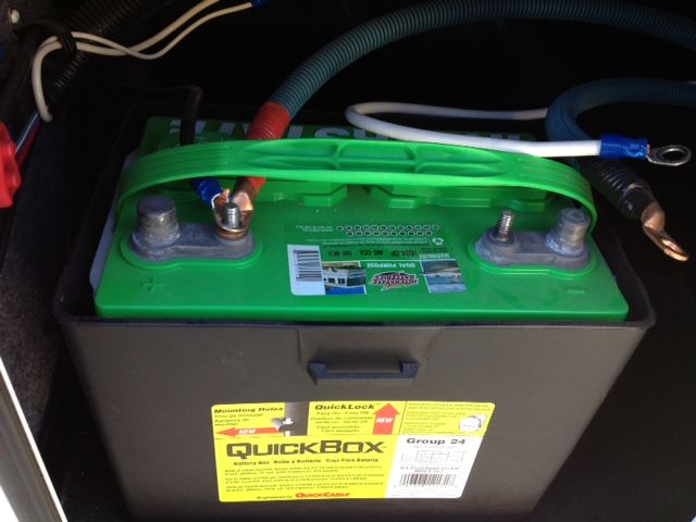

As you may know on our last primitive camping trip, our new 12v deep cycle battery died during the night as the heat was running a lot.
After talking to other campers, and my local battery expert, it was decided going with 2 golf cart 6v batteries in series (therefore equaling 12v) would be way better than any single, or double 12v setup.
I learned you can get the 6v batteries in AGM (maintenance free), or "regular" style with which you need to check the water in the cells at least twice per year in an RV situation.
I opted to go with the "regular" style 6v, as they were a little stronger in reserve capacity. My batteries are Crown brand.
****Note, when working with batteries, take the NEG cables off first when taking the battery out, and put the NEG cable on last when installing to be extra safe by avoiding sparking.*********
First, I took out the 12v battery, of course noting the polarity of the posts and noting what "accessory" cables went where.
Then, I cleaned out the battery box/tray of any particulate matter, and installed 2 layers of 3/16 neoprene to give some shock absorption and to prevent battery slippage.
Though I had enough horizontal length in the battery tray to put both 6v batteries in side by side, there was some wiring on one side of the tray taking up some space, and the opening to the battery tray is a little on the narrow side, so I ended up placing the batteries as shown.
***After battery placement the first connection made was the single connection running from POS on one battery to NEG on the other, thus placing the 6v batteries in series, thus ending up with a 12v setup.
Note the single connection in the photo. (Disregard the smaller black wire on the post above the illustrated wire, as I was already trial fitting the pos terminal wires when I took this photo!) **Again in the beginning, pay attention to the wires on both posts of your original battery, as "black" wires can be on the POS terminal, and "white" wires can be on the NEG terminal. Just take a pic and you'll be good to go!
Now just put your connections back on just like they were on your original battery.
****Note, you are connecting the POS cables first on ONE 6V battery (the left one in my case), and then ending by connecting the NEG cables on the OTHER 6v battery (the right one in my case)
Then you are done, and you'll have the best battery reserve to get you through the times when you don't have any shore power!!!
Hope this helps!!
