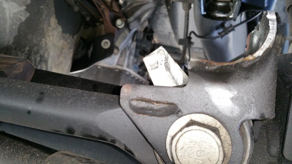

I have a 2014 ram 2500 4x4 with 17k miles nothing but highway miles on the truck so far. I was driving down my road leaving the house when I heard a loud pop and lost control of my truck. Long story short some welds broke on the frame that are connected to my suspension. Has anyone ever heard of anything like this on a brand new truck? Any ideas how I should handle the issue Chrysler has had my truck for a month and it is still not fixed.
They are sending me pictures I am very disappointed in the customer service that I have had from Chrysler. They just informed me they are taking about replacing the frame which doesn't make a lot of sense to me. I will post the pictures when I get them. I'm hoping they stand by their work and give me a new truck I'm not sure I could trust that one again.
And this guy
Here are two better pics and a markup showing what looks to me like welds that are not fused. I think dieselwelder is right.

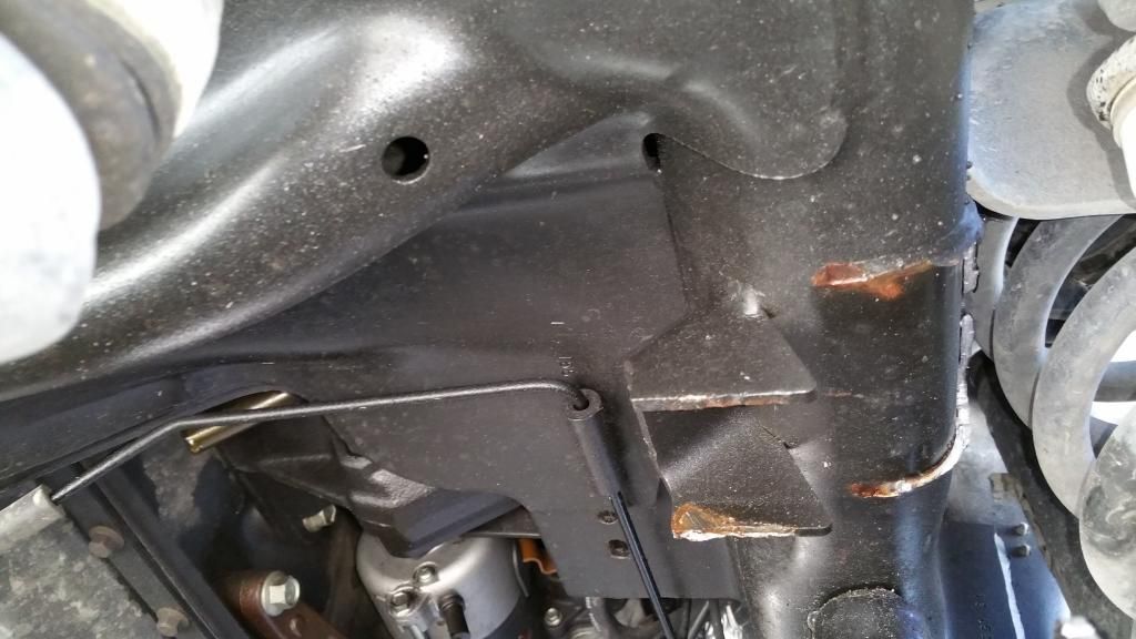

Looks like I have some rust under one of the welds

4,104 Posts
Well looked at mine today (its a jan 2014 build date) and two things annoy me or that I perceive about them.
1 Why dont they have the welds go all the way to the end of the joint being welded. When you stop early it usually always causes a stresser at that point which leads to cracks developing.
2 If you look at the 4th picture in post two I think it is you can see where the bracket side of the weld looks like good penetration, even not round and beady lookin. On the frame side the weld looks like it is laying on the frame, it looks to have bad penetration. Atleast to me, be nice if some welders in here could chime in maybe. It looks like a weld that is not adequate for the thickness of metal they are welding too (too low a heat/voltage, to quick maybe).

13 Posts
Frosty 42,
The welds in question are the ones that were welded by a person not a machine. All the welds in the pictures look like crap to me. All though I do not weld day to day any more, I was trained in the art/skill and still use that skill periodically thanks to my relationship with my contractor who is signatory with UA Local 208 Pipefitters Denver, Colorado. Before anybody chimes in, I will be the first to admit that we are not structuale welders like my Iron Worker Brothers. However, I believe we are the only trade (In this example I include pipeliners as pipefitters as we do the same work more or less, weld pipe) that welds things from the inside out, and have to have our welds routinely x-ray inspected when working on critical pipe. With that being said I would have rather seen the welds in those pictures undercut than setting on top of the parent metal as they appear to be doing. The Welds, in my opinion look like cold welds that would pop right off. In fact, some of those welds look like a wire flux welder was used ( possibly a stick welder, but I doubt it) and they didn't even knock the slag off before they painted it. I say this because of how smooth and rounded the weld is. I would be interested to see some pictures of some 2015 trucks that have the robotically welded track arms to see how different they look.
