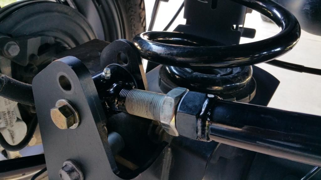

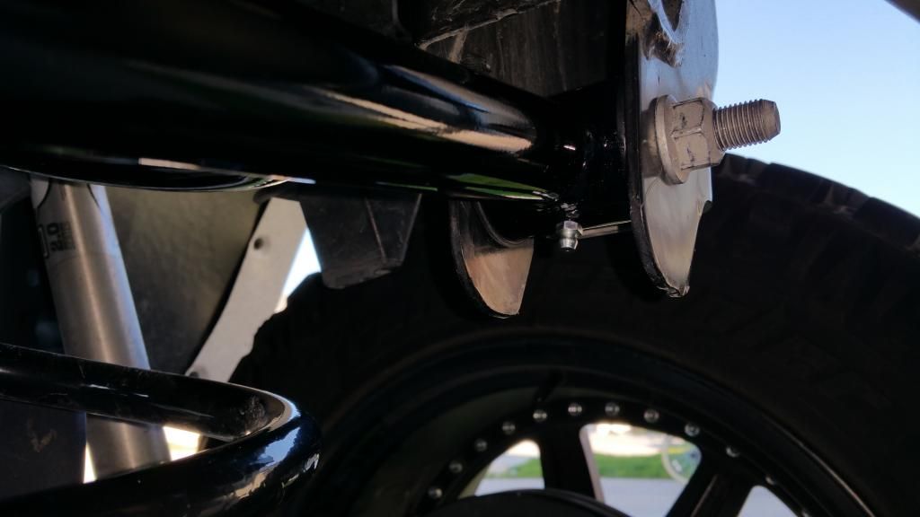

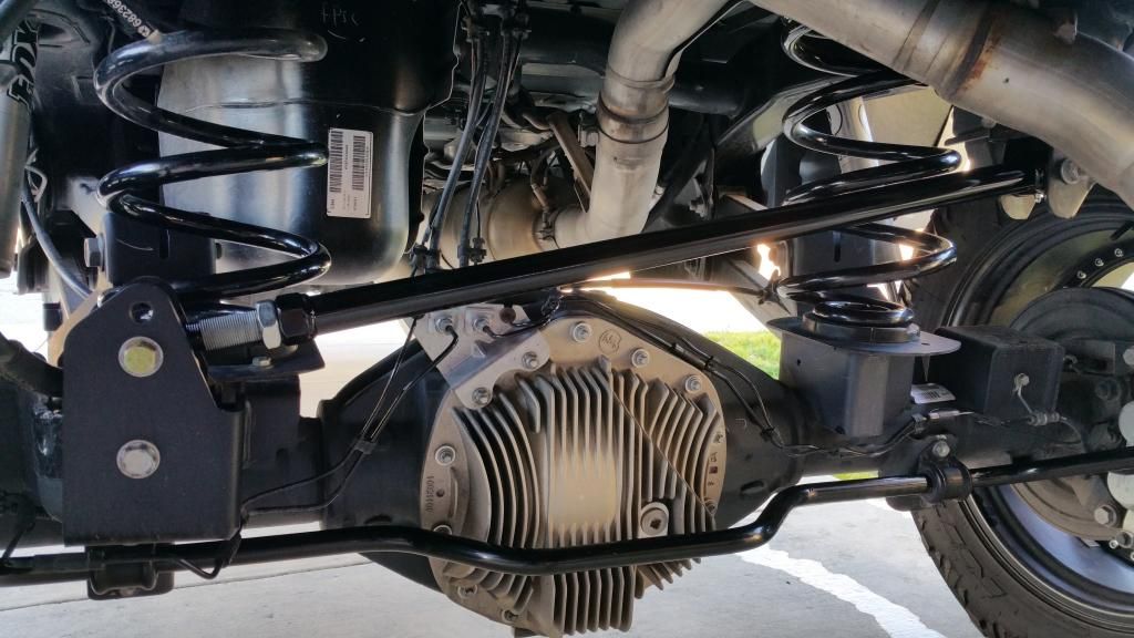

So I had a chance last night to install my Traxda 1" rear level spacer on top of my 4 1/2" BDS rear coil springs and the new adjustable track bar. Was painless and quick took about 1 hour for both, and about another 30 minutes to adjust and center the rear end. She sits perfect now with about 1/4" forward rake. The track bar is a really nice quality piece. Heavy duty DOM tubing with zerk fittings. Way better then the flimsy OE piece, unfortunately I forgot to take pictures of them next to each other. And the best part it's under $140 shipped. Looks like it's from a smaller performance shop as well which is a plus to me. I really try to support the smaller mom and pop retailers when I can. I'll get pics of the truck when I get a chance to give her a bath.
I should mention the BDS 6" lift kit comes with a rear track bar relocation bracket which brings the rear end to within about 1/2"-3/4" of being centered. Since adding additional lift and me being OCD I opted for this addition. What's another $140 bucks after spending thousands of $ right....lol...!!

Word of advise, pull your bar apart and put anti-seize on all the threads.
Reactions: SATX_CUMMINS

I'm doing a 1" rare spacer and was wondering about the bwoody bar bc alternative was icon and it was $367! I just ordered the bwoody. Thanks for the write up on it man.
