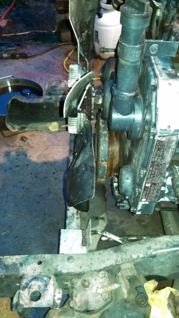

okay decided to eliminate the fan and run electric fans. started putting the front end on and start test fitting. everything is turning out well except for the inter cooler. problem is there isnt much room available.

The radiator support can be cut to accept a first gen intercooler, I am working on one now.
I will post pics of it you would like.
PS how much room between the rear valve cover and the fire wall?
Yes I would love some pics! Is there much difference in the 1st and second gen cooler? If not I have the one from the donor truck.
Also motor has about 2.1/2" from the firewall. Only thing needed was moving the cross member. I'll get a picture this evening
The first gen intercooler is smaller and so fits in the chevy grill shell, the second would require rebuilding the shell and alot of trimming to fit behind the grill, it will require a differnt hood latch and may also interfere with the head light buckets, I don't remember for sure now.

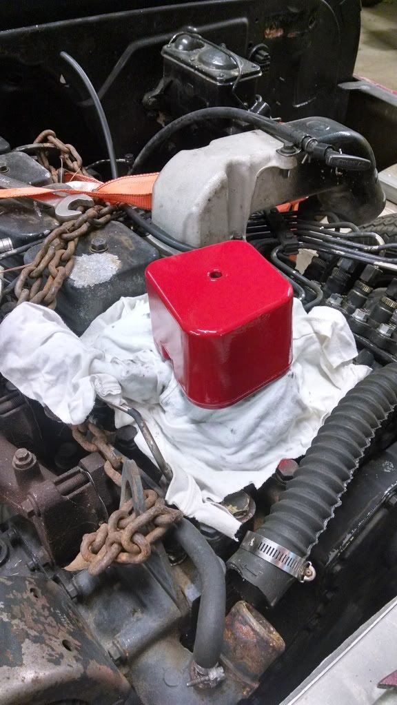

Well with college and work being slow my funds haven't permitted to buy any parts for the truck. Im at that point on the truck that without parts its kinda at a stop.So tonight I go started on some painting. Started my valve covers and also the compressor cover on the wh1c.
