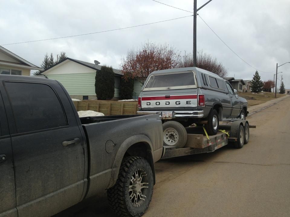

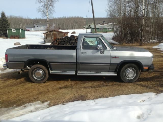

This will be my build and restore thread for my 91 D250 non intercooled automatic. I bought this truck in April 2013 from a nice old lady, and that makes me the third owner. She and her husband owned it since 1996 and used it to pull there 25 ft bumper pull camp trailer during the summer and parked it in the garage during the winter most years. In 2006 they had a new cab and box installed. From 2006 to the summer of 2011 they put almost 12,000 dollars worth of repairs and replacements into the truck, and kept all of the receipts. They were planning on keeping the truck, but in late 2011 her husband passed away and she had no further use for the truck. The interior is in great shape and there was only some minor rust under one of the fender flares on the box. The frame has some rust, but nothing that threatens the structure or strength of the frame. I'm focusing on the body work first and then I will dig into upgrading the engine and drivetrain. This is a budget build as my wife is pregnant and is due next month.

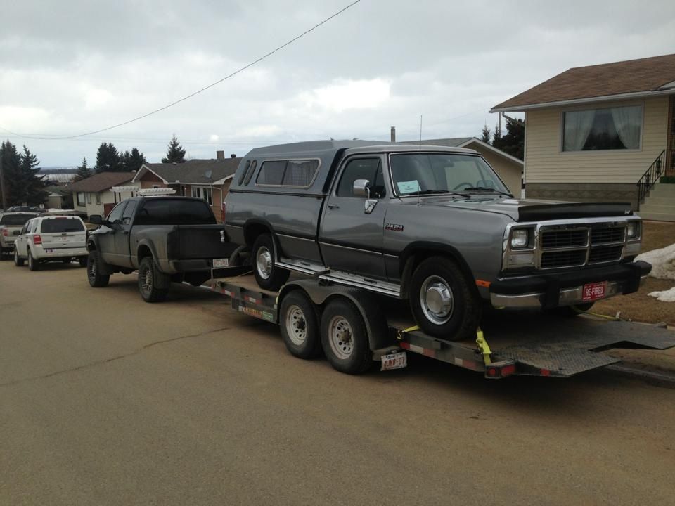

The day I picked it up:
On the way home:

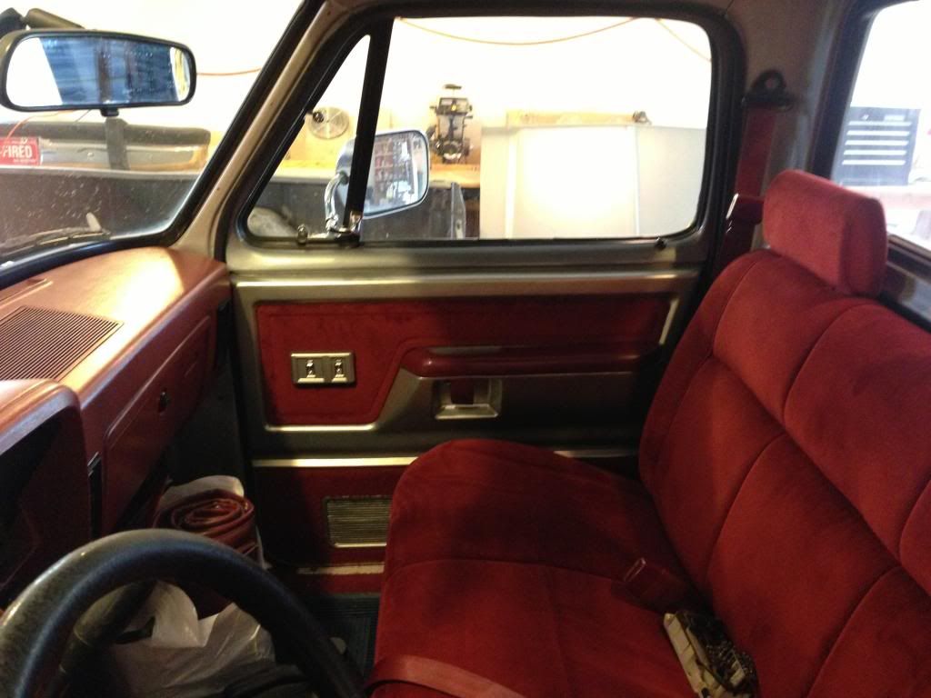

The interior:

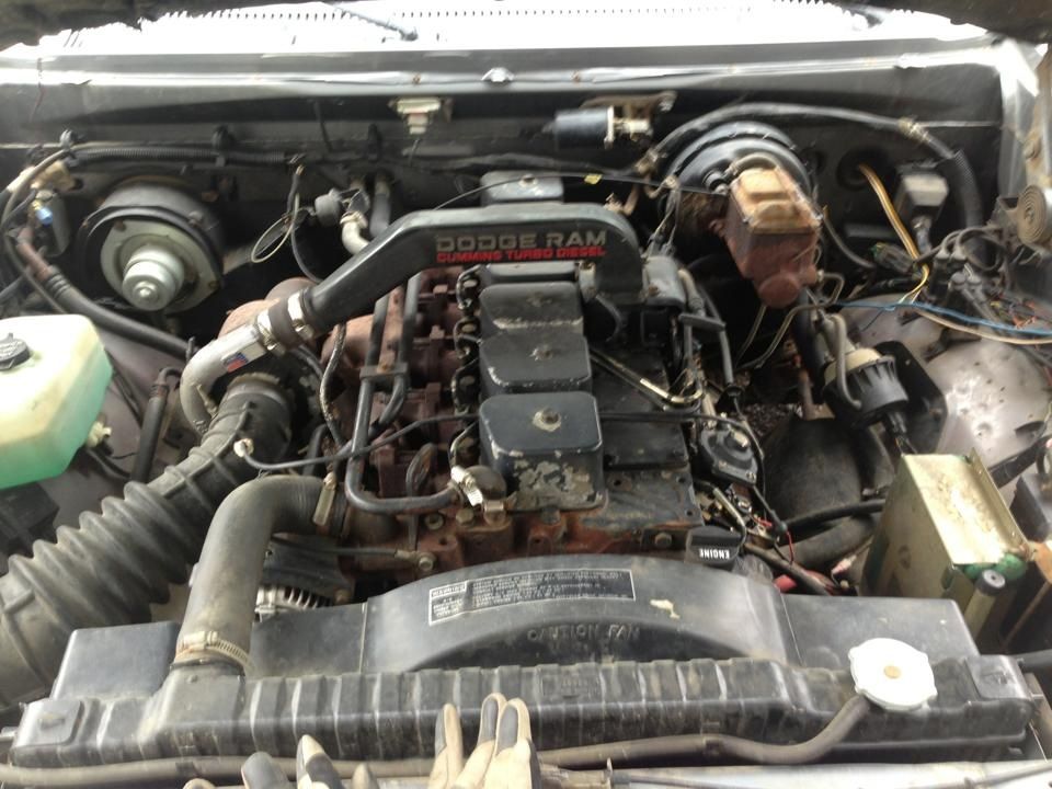

The engine bay:

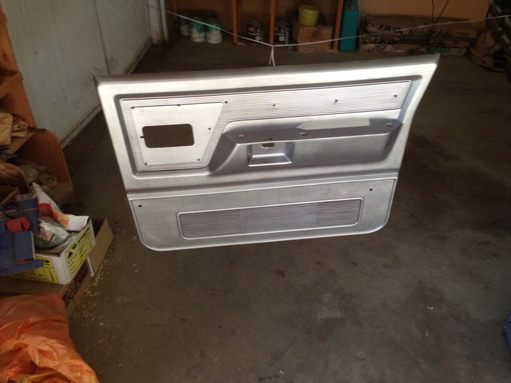

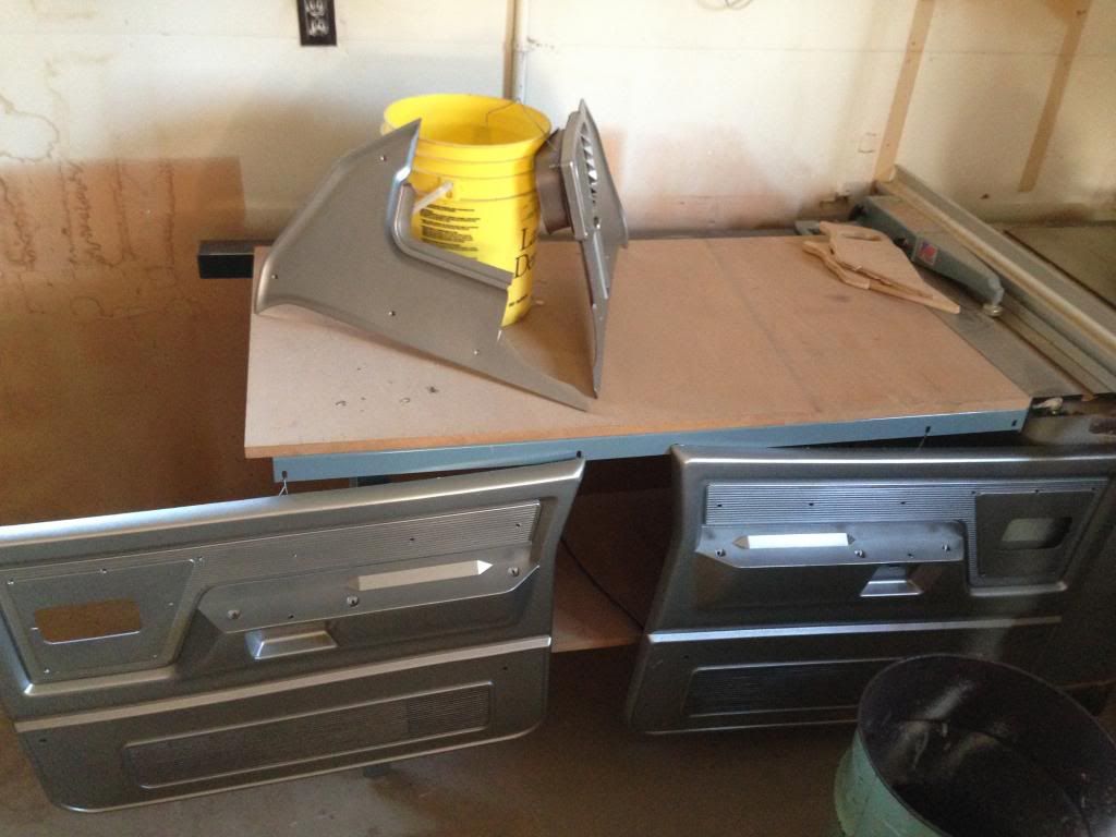

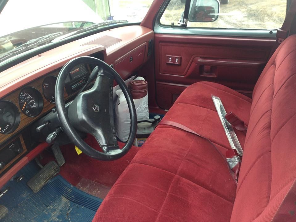

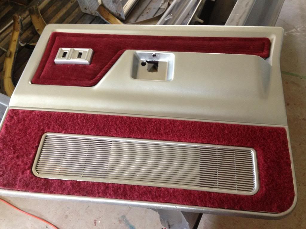

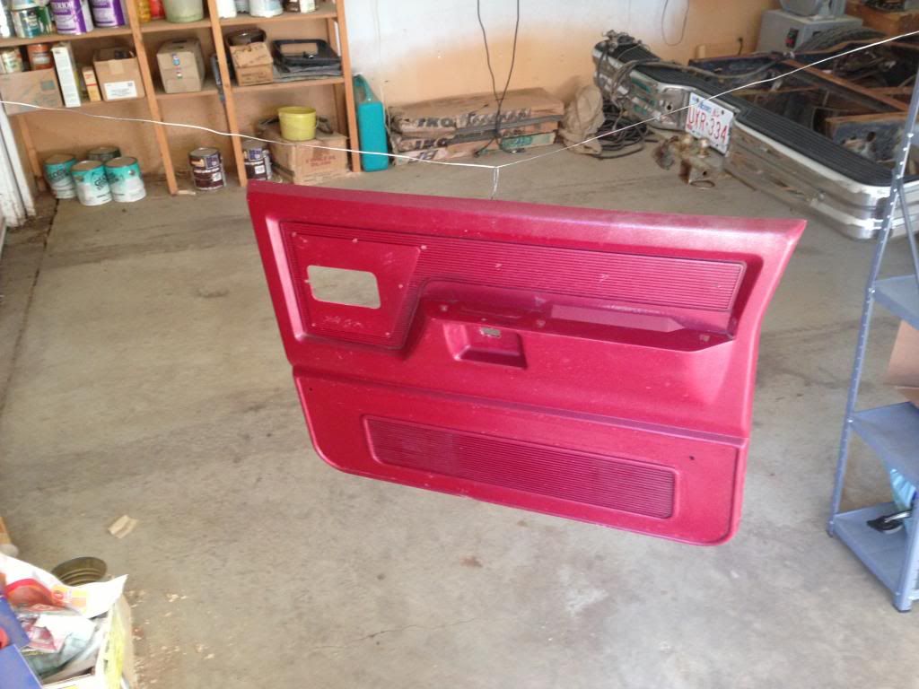

I wasn't a huge fan of the all red interior, so I took the headliner, along with all the trim off and junked it since most of it was cracked. I'm not going to re-install a new headliner as I like the silver metal roof. I then took the door panels, and kick panels out of the truck and tore them apart and painted them silver.
I then re-installed the red carpet on the door panels.
Door panel installed after the new paint.

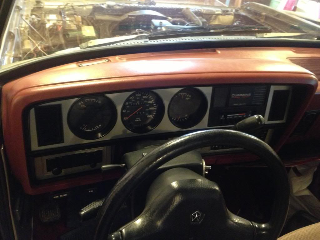

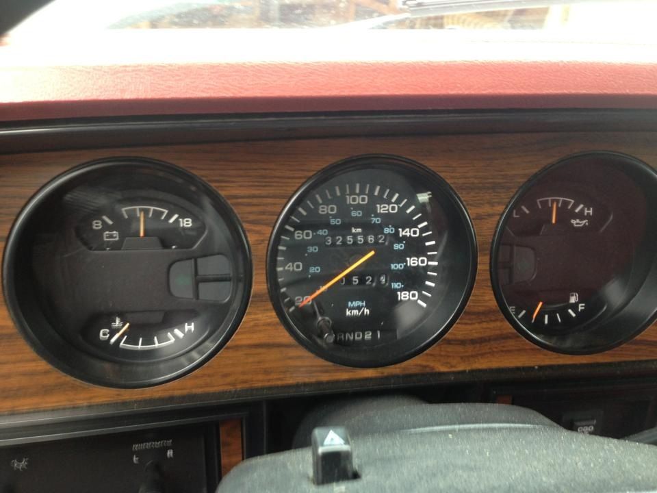

I've never been a huge fan of wood grain so that was the next thing to go.
Before:
After:

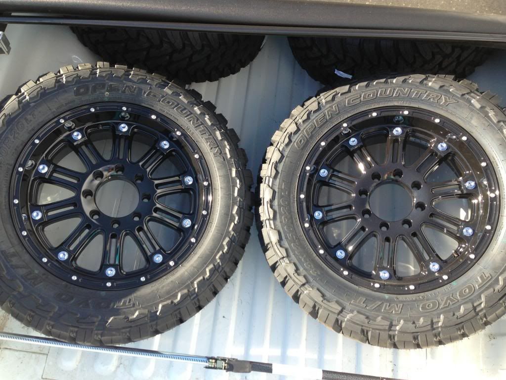

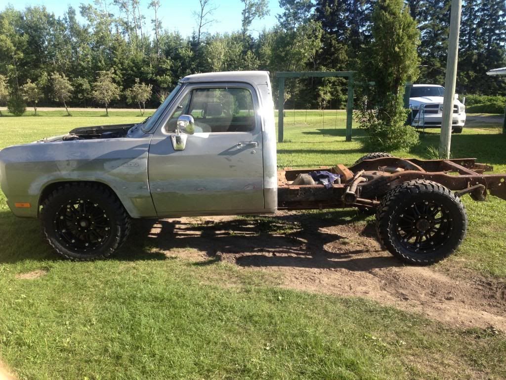

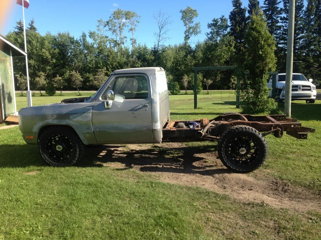

Now comes the good part. Before my wife and I started our budget she let me buy wheels and tires. They are 20x9 XD Hoss with a +18 offset, and the rubber is 33x12.5r20 Toyo MT Open Country's. I bought them knowing I wouldn't be able to turn once they were on but I was surprised once I installed them. Even with the saggy front springs I had very minimal rubbing and after a tiny bit of trimming I can turn from lock to lock without any rubbing unless I hit a good size bump while turning.
Here's a pic before I installed them.
Drivers side. My drivers side coil spring is 1 1/2 more compressed than the passenger side so I will build some cheap coil spacers for now and hopefully get some new coils down the road.
Passenger side.
A pic from the back to show how wide the tires are.
And a final pic with the hub caps. I still haven't decided whether I like them or not.
I welcome any comments and I will be looking for suggestions to help me keep this build low budget and cover anything I may over look. I know that by putting fat tires on it that I am ruining a good truck according to some, but I like the way it looks. :party018:

So I'm looking for some input from guys that know more about these trucks than I do. I have a "mystery box" next to my battery and I have no idea what it is. I disconnected the power and ground wires that run to it since I have no idea what it does. Here are some pics of it.
Here is where its wired into the fuel system.
Where it is plumbed into the air intake

Some guys on dieseltruckresource forum think its a hydrogen snake oil generator. You put distilled water in it and then an electric current gets sent thru the water and makes hydrogen that supposedly helps fuel economy. I've never heard of them so I'm just going to disconnect it.

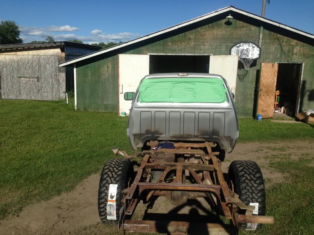

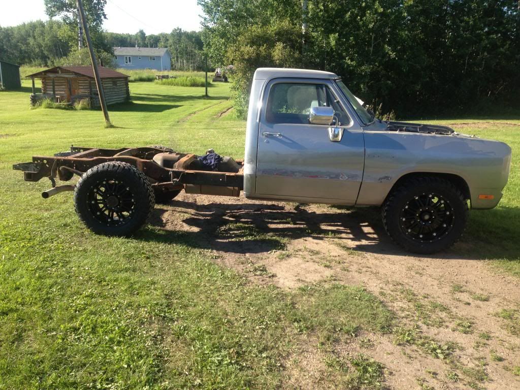

Finally got some time to work on my truck some more. I got all the bed liner off the back half of the frame, and wire brushed all the extra chunks of rust off. I also strait piped the truck. Its crazy how good these trucks sound. I got some practice welding. I filled the holes in the front fenders where the badges were.
I will drop the fuel tank this weekend if I get a chance and clean out behind it and then coat the frame with some POR-15.

Thanks everyone for all the compliments and suggestions. So I was able to get the frame clean and painted this weekend. I'm pretty happy with how it turned out.
Frame wire brushed
Frame painted with POR-15
Then today I ran my wiring back to the back of the truck, and then I got a friend to help me set the bed on and line it up. I'm pretty happy with how the truck looks now. I may still raise the front a little and drop the back a little to level it.
