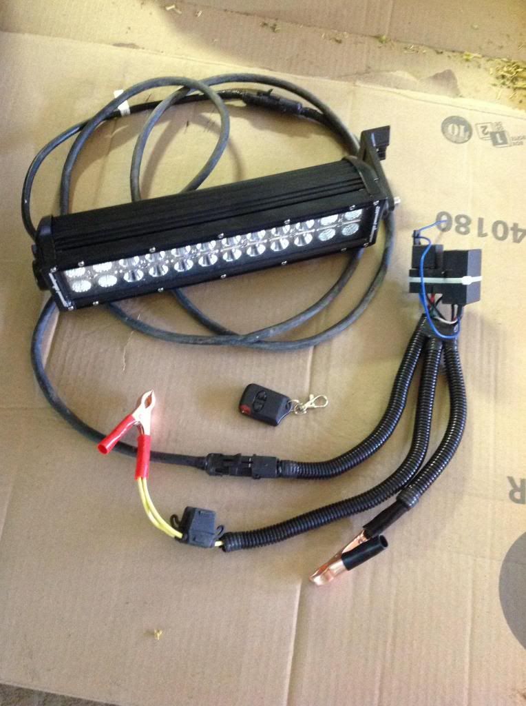

Got this idea from member davecs2 thanks. Liked the idea but as fate has it the wife would kill me if I got one for every piece of machinery here. Got the remote control box and two remotes, hooked them to a 30 amp relay and some fuses and battery post tester clamps and connected them to a a cord with weatherpac connectors( incase I need a much longer extension to batts). Now all I have to do is unclamp from batts unbolt the light and move. Have a few made of these with led bars and work great.
