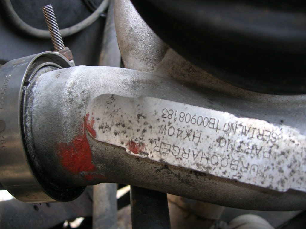

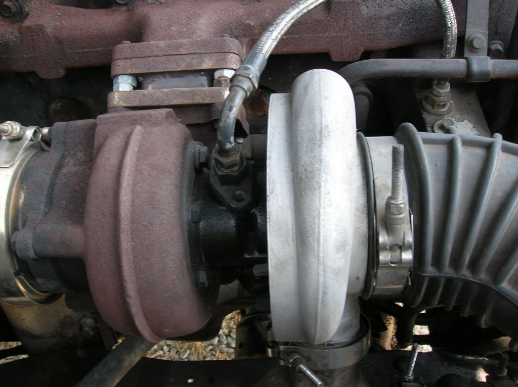

I just picked up the truck and still getting used to it. But so far all I know is it has a new HX40W turbo. 4'' turbo back exhaust. The star wheel turned down half a turn and the fuel screw in a little bit. It only blows smoke if you stop on it from a stop. Its not thick, its more cloudy and dark. I was getting 20mpg going down hwy and then i played with that screw and star wheel. I dropped down to like 13. I also put some 285/75 SSR swampers on it. So it could of been my right foot, trying to see if it got more *** out of it, or the tires or the fact I messed with those functions. It seems to spool just fine, but still seems to be a big turd. any ideas?

after you messed with the starwheel, does it smoke more?
turning down the starwheel does not give you more fuel, or more power.. it gives faster fuel, which isn't always a good thing. running correctly will give you the best power and best mileage. normally a good start is to turn it all the way down, and count the turns. bring it back up about 4 full turns. then move in quarter turn increments down and back up to see what works better. the starwheel can cause a lot of lag if you have it up or down too much.
as for mileage.. drive it nice and easy for a tank, and see where your at.. that way you can rule out your driving as the sole cause for the mileage drop.

thats a chinese knock off hx40
