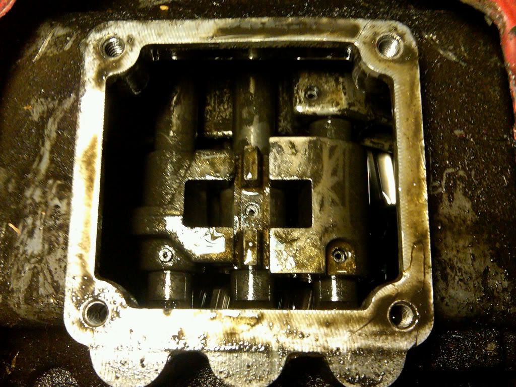

Ive had a problem with my truck gettin stuck in 5th gear every since my parents used it to haul the camper. I have the modified locknut so i dont think thats it, But it will not get stuck in 5th if your driving and you go to shift down to a lower gear. It only happens when you are in reverse and then try to shift out of reverse. instead of lettin me shift into nuetral, it just strait goes into fifth? Now i took off all the stuff to see the top of the transmission and i see this...

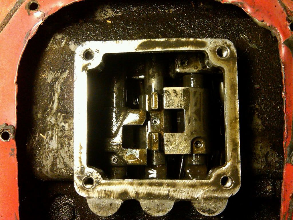

So i just pushed in the clutch and used a screw driver to move the U shaped thing on the left to line up with the rest, and it looks like this...
So after that, the truck will shift throught the gears like its nothin and wont get stuck. But after i drive it for a couple days it'll get stuck again? Do i need to rebuild or what? Somebody told me that my shift fork might be wearin out or my synchronizer is goin bad? any ideas? thanks in advance

I appears to me that the bottom corner of the left side middle finger is broken off. Try shifting by moving the stick in the pattern rather than letting it slide left or right.
That corner is not broken off. It was made that way. Why? I don't know. If you start reefn on it when it is stuck in 5th. the little knob that that moves those rails will pop thru that gap and you will be stuck in nutral with the tranny locked in 5th. Had the same problem. Ther are three blocking keys that the shift collars and syncros ride on, held in place with outward pressure from a springy wire ring. If the ring breaks or one of the keys wears and gets jammed your stuck.
yes thats whats happinin to mine, the knop is poppin up out of the slots. but I was told either the knob itself is worn out and I can get a new one to fix it, or that the rails are startin to have play in em and that someone makes shims to put on there somehow to keep them from havin any play. Im gonna get it checked out soon and it doesnt sound like it should cost too much or take up too much time.
770 Posts
When I did the exchange for a rebuild the top cover was not included. I put the old one back on and have had no problems. If there is any wear it is usually in the shift forks from driving with your hand on the shifter. The knob on my shifter was shiny with no wear. When I shift in and out of 5th now I don't rush it or push up and over on the shifter at the same time. By the time you need 5th you are pretty much up to speed anyway. No need for speed shifting.
