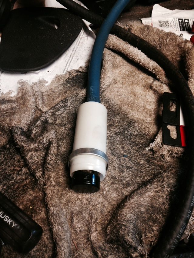

Ok so here is the story. I bought a 99 3500 with 130k, the kid/guy i got it from had no idea how to wrench on the truck. i have dealt with a couple of these vp trucks and know my why around them. i got the truck home and changed the starter, and it wouldn't start so i primed the system cracked the banjo bolt on the side of the vp and got a good prime tightened it up and it started up. i noticed a couple of the fuel lines had a small pin hole so i replaced those and re-primed and it ran great. for the passed two weeks while working on the truck it would start up but run rough. i changed the fuel filter and i noticed that the filter housing was half full of water. so i pulled the tank and drained all the fuel out and got 3.5 gallons of water out of the tank. the best part was the fuel looked like lemonade not the bluish color diesel normally is. put the whole system back together and and now i can get a prime i will tighten the banjo up and i can hear the fuel go back into the tank and the system will loose its prime... so today i replaced the lines from lp-filter filter-vp thinking there could be another pin hole or bad banjo bolt washer. same thing back feeds into the tank.. so i i have a jumper wire for the lift pump so i set up a 5 gallon bucket full of diesel next to the truck and ran a hose from bucket to the lp with my jumpers to the battery got a prime tightened up the banjo bolt and same thing. (doing this eliminated the chances of the line from the tank being bad or the lines in the tank being bad.) no i replaced the stock carter pump with a raptor pump that i had laying around. got a prime and same thing happened. replaced the filter thinking it could be an oring still did same thing. swapped the filter housing with another i had, same thing got prime and then as soon as i take the power from the pump away all the fuel drains out of the lines and i loose my prime. each time i will prime to a constant 12-15 psi get a steady stream of fuel from the return line off the side of the vp. i have started the truck up and it will run fine now with good fuel and as soon as i shut the truck off i loose prime. no leaks and no noticeable leaks or puddles with priming or running or sitting. i replaced the gas cap also and every line fitting and o ring of the fuel system... so before i set fire to this truck someone help my head hurts from doing this all day :banghead:

okay everyone i have figured out my problem. so after draining the tanks and putting in 15 gallons of fuel the fuel level was lower then this piece of the sending unit that was in the tank. so i took this piece out got a 3/8" line and drilled a hole into the bottom of the sending unit so ts like a draw straw type set up. it holds a prime so i think the metal ring was not holding a seal and with the ring above the fuel level it was taking air from the tank and making the system loose its prime. i did this all this past weekend and then yesterday i went out and the truck fired right up. :party018: thanks everyone for the help.
