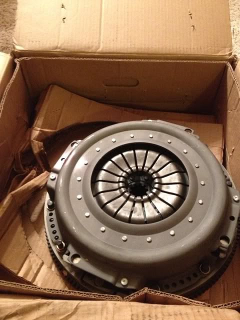

Dual Disc (valair's new quiet organic dual disc w/ hydraulics)

I spoke with Nick at valair last night for a bit and we both were on the same page as far as clutches. I didn't want the typical chatter of duals but felt it was the best route over all. He asked me about running their new quiet dual disc that has a strapped floater or something along those lines. I said sure, it was the same price as the regular version. I asked about the hydraulics and he told me the stock stuff would hold but for piece of mind and adjust-ability, go with the new hydros so i did. Should be at the house on Wed!
