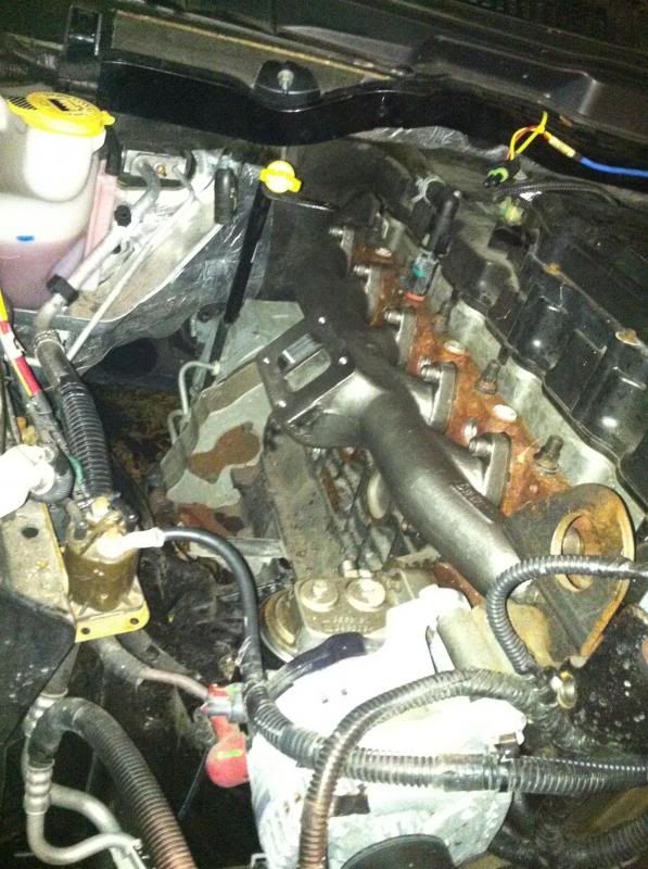

Well I started my swap tonight. Got old manifold and turbo out as one unit wasn't too bad. ended up draining all my coolant which is fine with me I'll pick some up tomorrow along with some flex pipe just incase I can't get my exhaust fabbed up. Old downpipe is removed and new manifold is installed.
Tomorrow morning I'll head to the store to get some heater hose and coolant and flex pipe and get her finished up. I got Stainless's earlier kits because now you don't have to get anything for the coolant system all the heater hose is included. But one part that gave me a little hassle was the lock brackets that they put on cylinder 5 and 6 so they don't come loose. Took me 4hrs of work today and 2 bs with my buddy that stopped by.
