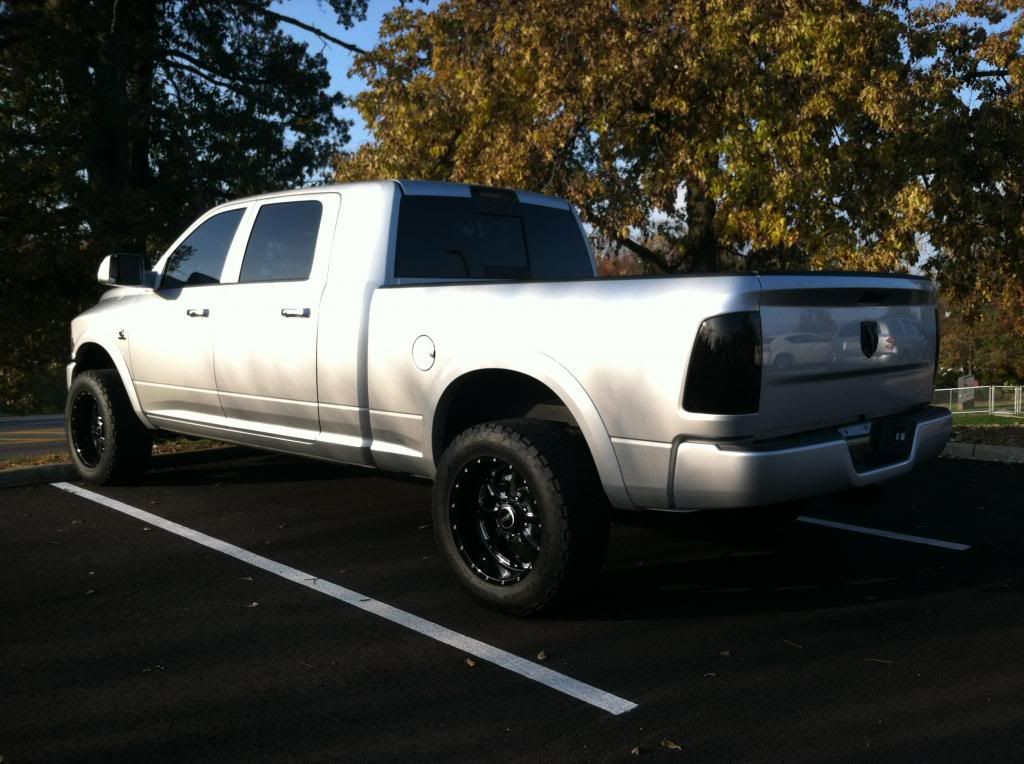

Here is the truck that I'm working with....
Reactions: 5

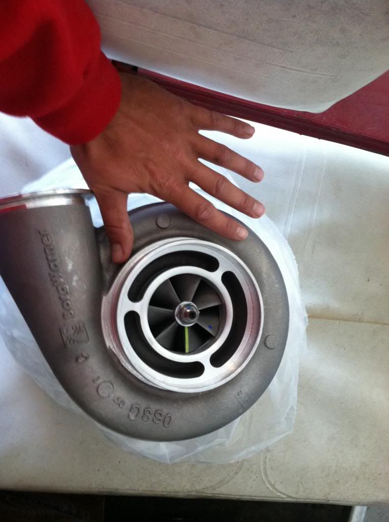

And here is a few of the FI s472 with a 2nd gen swap kit from Source Automotive. I went with a Steed Speed manifold, I have never used or been around a Fleece 2nd gen swap kit but I can say that Source's kit is top notch everything looked and fit great. As of now I am running stock fuel as I said. Pictures don't do this thing justice it's a man eater lol. I struggled like no other trying to get the four nuts loose from the manifold to the turbo so I said heck with it and pulled it out together. That makes for one seriously heavy combo.
In the picture above I did have to relocate the solenoid shown well in that picture. I just removed it from the battery tray and screwed it in to the battery tray underneath. Also I ran to the parts store and picked up different manifold bolts for a cleaner look.
Reactions: 3
