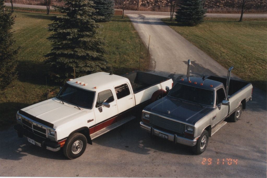

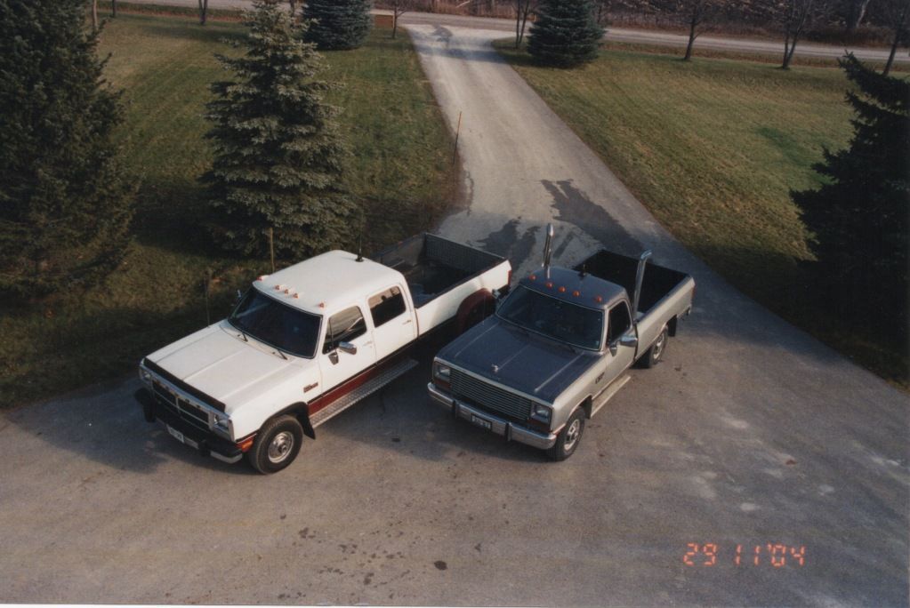

One morning in August 2004 I found more than I ever bargained for. I found a crew cab, dually, 5speed, 4x4, Cummins converted Ram on the west coast Canada. It was exactly what I wanted so with the intent of selling my truck, the 1993 crew was purchased and shipped to Ontario after some arrangements and assistance by an understanding father. By the time it arrived in late August, I was back to school and did not really have a chance to work on some of the smaller issues a 15 year old truck had so it sat for most of the winter and come next summer, I started driving it. It was then that the 1990 was going to get placed for sale, but I had an unforeseen issue: The Crew cab tranny was shot despite what the Dodge dealer had told us. So a rebuilt getrag was located in the hands of a family member amazingly and the plan was to swap it in on summer holidays. Issue is, I am a perfectionist. After much more time on the TDR forums, I learnt about the weak Getrag and how the issue I was having would surely return in time to the rebuilt Getrag if used for towing, so plans on swapping it in was modified and the search began for NV4500 and eventually a NV5600. In a nutshell, I ended up doing way more than just the tranny on it. But I am getting off topic as usual! Just remember the Getrag that was freshly built not being used in the crew cab anymore. We will hear about it again! ;)
So, back to the 1990. The for sale ad was never placed as dad thought it best to get the crew cab’s tranny fixed before I lost my means of transportation (solid logic). So I kept the W250 but did not put anything into it as within a few months the W350 “should” be finished. This was 2005. For more info on the crew cab, see here:

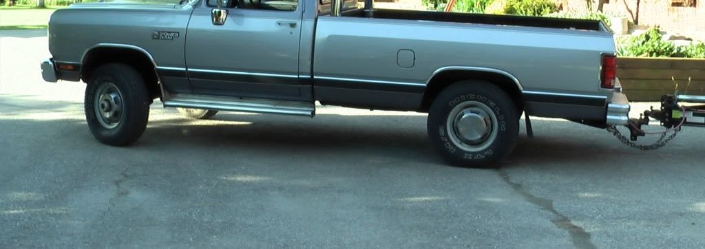

So I ordered up a new set of Alcan springs made to my specs. I believe it was 3000 lbs per side I did. It came with 10 leafs per rear and 6 per front. I also asked them to give me a 1" lift over stock. The old springs sat at 38” front ground on the front, 37. 5 rear. The new are 40 F / 41 R. Keep in mind the calculation is more than 1” as the old springs had sagged from factory ride height. For shocks, I went with Bilstein 5100 series. Waited 8 weeks for them to arrive!
Other than Alcan installing the wrong rear bushings (3/4 instead of the correct 5/8 bushings) they seem to be a great company to work with! They did send me out a set of stainless sleeves to install into the incorrect bushings so the bolt would fit correctly. I also used all new grade 8 bolts from my local hardware supplier. Cost was $230 per front, $240 per rear. With shipping was about $1,200.
Looking back, glad I did not re-arch. They wanted $125 per side to re-arch plus then would need new bushing at $30 per spring. As it was I had to cut the rears out so better to have new. I do like the springs, but if I could have afforded to do air ride, I would not think a second thought on springs.
Here are a few pics of the old springs with some sag. Look a little weaker:
The above shot was right after I loaded something onto the flatbed at a friend’s place. LOL I had to drive like that although fortunately not far! Was the day I also decided springs were needed on the rear. :D
