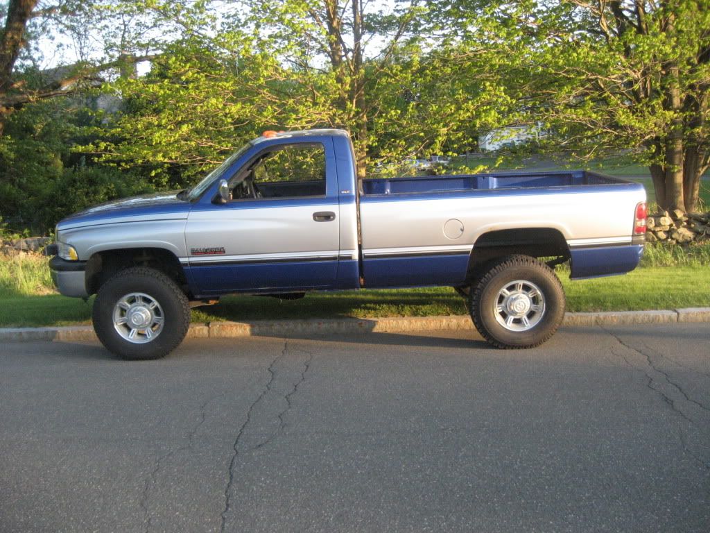

first it all started with my 12v, which was mostly stock with a 4" exhaust, ground and hammered fuel plate and H2 wheels. i loved almost everything about that truck but wanted an escb:
