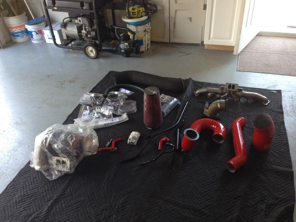

Here was everything laid out before I started throwing things into the truck.

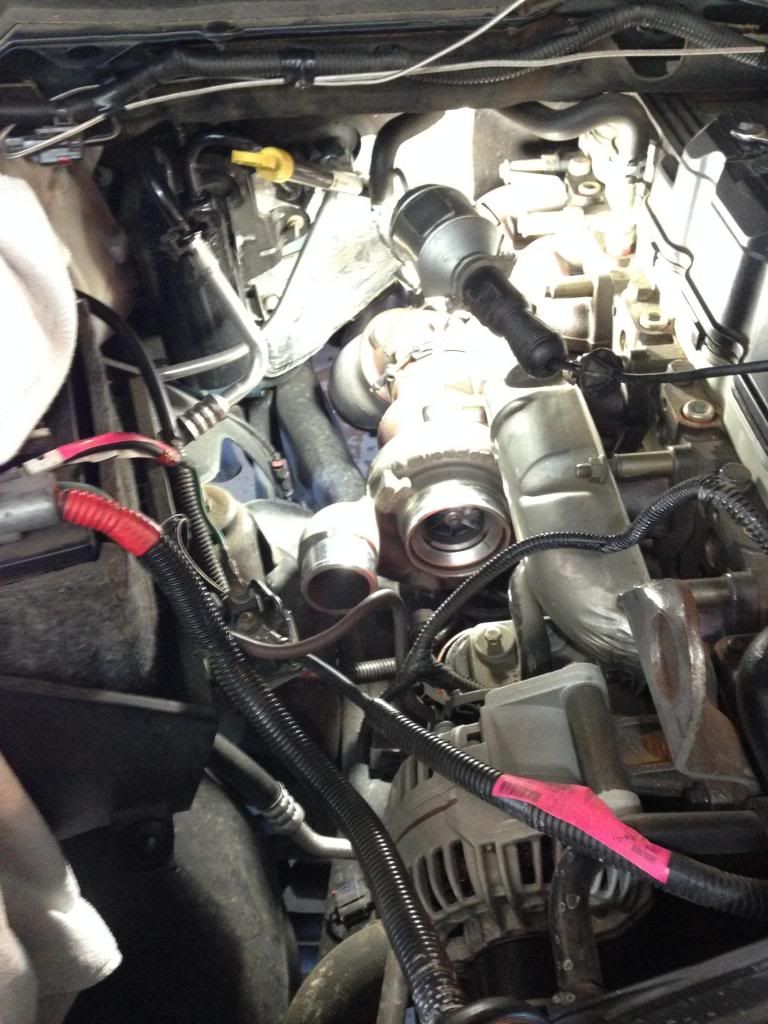

Got most of the piping removed, with just the stock turbo and manifold left to take off.
Everything off, with just the downpipe left.

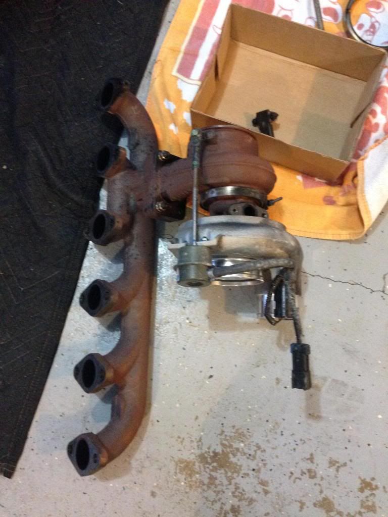

Stock turbo off
