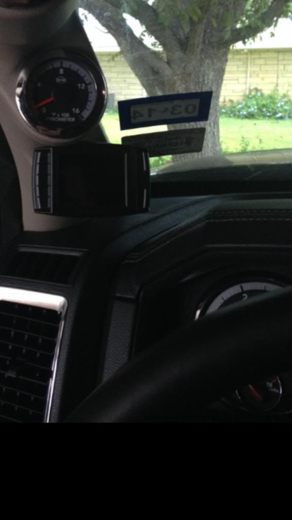

I just got a mini about two weeks ago with MCC from Draconian Diesel:thumbsup: and at the time I only had a two pod gauge A post mount. Now after I got the mini I wanted three pods and put the mini in one since they make an adapter. As you can see from the pics it doesn't fit straight across like I want it too, I hate the angle it sits at because the top of the mini hits the A post. I don't know if it would fit better on the bottom then the top and I'm not against that but my problem is the wires for my two gauges are not long enough to reach to the top two holes.
What have some of you guys done for pod mounted mini's and have you had to cut to make them fit? I want to keep it on the A post preferably.

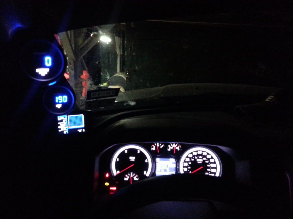

I bought a cup mount and screwed it to the side of my pillar for my minimaxx, but I have three gauges. Turned out good

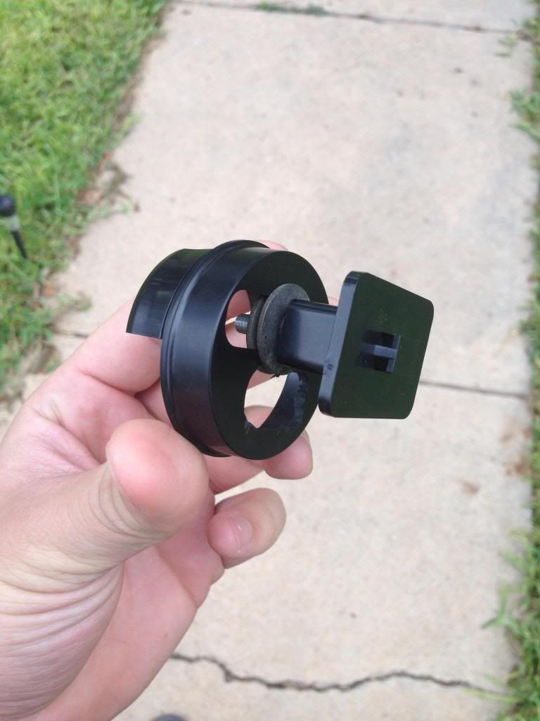

JASII, what is that adaptor and where did you get it?

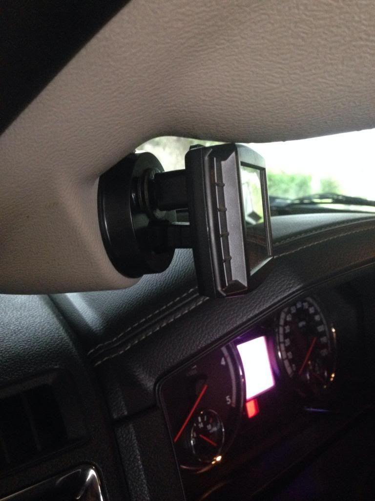

Looks like he took the end from the suction cup mount and attached it to the Pod mount. Great idea. I think thats what I'll be doing. :thumbsup:
10 Posts
That's exactly what I did, I took the original mount off and cut it about 1/2 inch from the back and then threaded it. Mounted it on the pod adapter and it worked perfect. I did have to cut a little on the pod adapter to make it work , to allow the USB cable to connect . I found the idea on here somewhere I can't remember but it works great and looks good too. I painted the washers black and it looks real clean.
