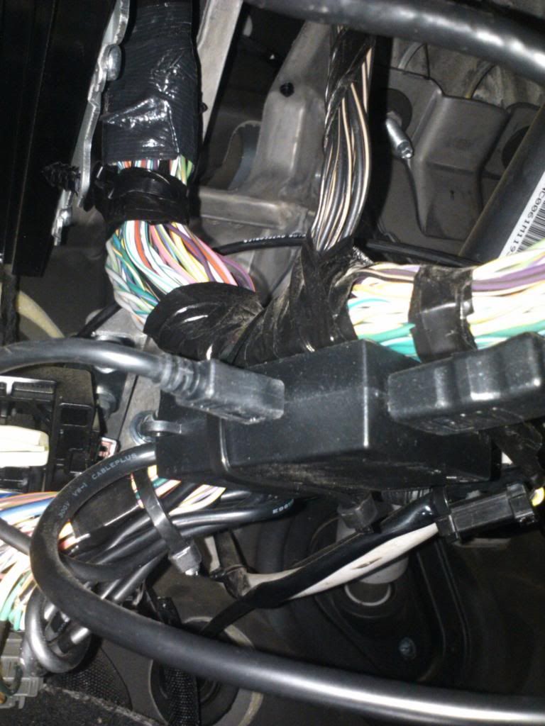

a little background first
been deleted since may about 24,000kms - no problems
last week h&s pyro started acting up - no big deal,
just jumping from 0-2600 and back, sometimes sits @ 1400 while
idling everything else on the mm was working fine, talked with H&S they
figure it is the php board(??) under the hood - going to send it to them
last night loaded some new tunes went for a drive everything good,
went for a drive today for about 500kms, about half way thru drive this happened (see pic) can't remember if it happened while driving or after a shut-off and re-start.
so my questions are:
what is happening?
what to look for and how do I fix?
is it still ok to drive like this?
thanks guys

My first guess would be a bad connection to the OBD port or the MM. Im sure you already checked those
checked the obd port seems solid and connected haven't had a chance to take of the pillar mount and check yet though, I will though
thanks

so it seems that it IS the pyro and/or pch board I traced the wire back to the board under the hood and un-plugged from the box under the dash ; turned key on MM fired right up like normal
does this seem right?? anyone else have this happen like this?
so now do I ship back and wait for a new one under warranty from H&S or should I go with a more reliable pch board and pyro?
