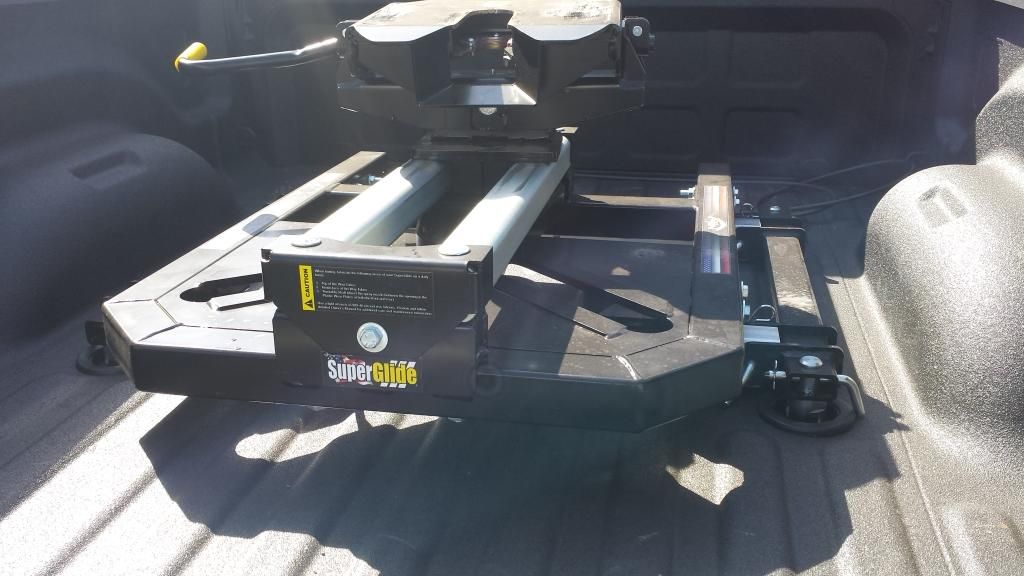

I have the pullrite ISR 24k hitch in the bed of my 2014 Mega. It slides 18.5 inches. It uses a capture plate to auto slide. I do not have to lower the tailgate when it starts to slide. It basically has a cam guide so the more you turn the farther it slides. When you hit 90 degrees it's at its full 18.5 inches but the pinbox is at 90 degrees so it doesn't hit the tailgate. The hitch is heavy and I'm using the pullrite picture frame adapter to adapt it to the factory fifth wheel prep package. I will post some pics if you are interested. Photo bucket is currently down for maintenance.

My trailer is pretty nose high with this setup. My pinbox is set as high as it can go. I have 7.5 inches of clearance at the tailgate. And with the pin weight at 2700 pounds plus the 300 pounds of hitch. The truck sits almost perfectly level.

Not sure if my last reply was sufficient. Are you asking for trailer clearance above the bed? Or are you asking how high the hitch is above the bed rails? The hitch does not come up over the top of the bedrails. If I remember right I had about 2 inches below the bed rail. I currently don't have the hitch in the truck to give you exact measurements.

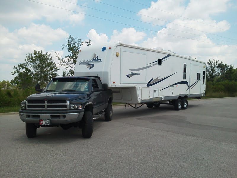

A few years ago, I pulled my "03 42' Holliday Rambler Presidential all over Texas, then up to N. Idaho for my wedding and back to Texas... Crossed the Continental divide 7x, and through the Grand Canyon and Yellowstone
So that is just a little on my experience with pulling a 5'er... I pulled that trailer with this POS (Not a fan of this hitch)

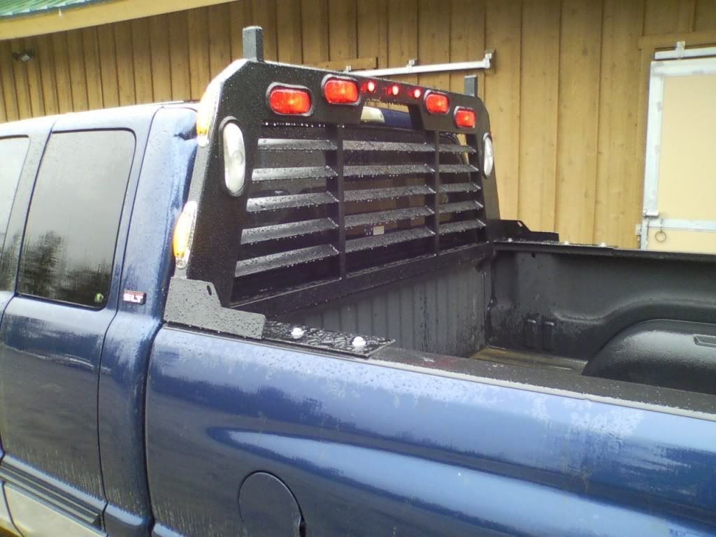

Now, as much as I did not like getting out of the truck in the middle of streets and having it bind up and the big thud when/if it locks in place... but I NEEDED the slider because of my headache rack on my truck (cab dent where there when I bought the truck... Long rodeo nights if you catch my drift), and even then it was CLOSE
, and inch along on any turn with an incline.

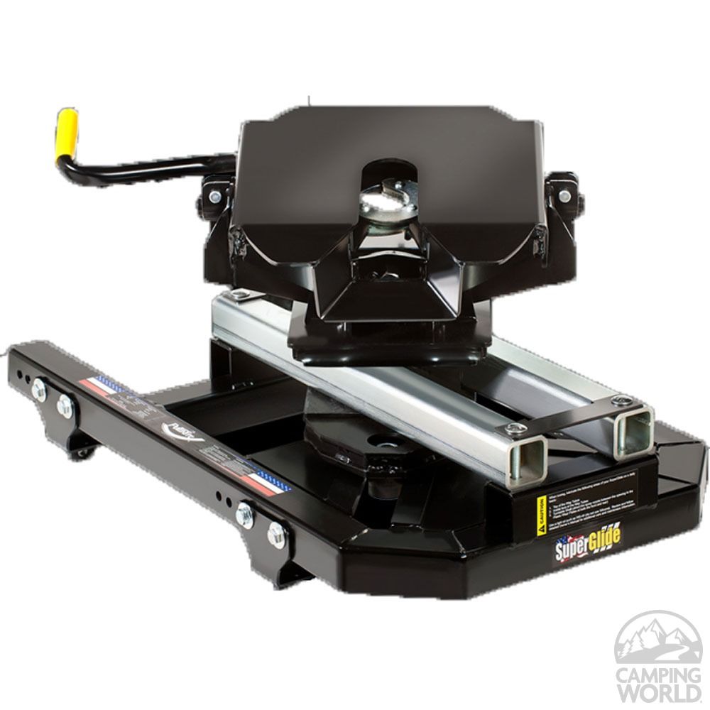

1) The 18k Pullrite Supergluide ISR (Industry Standard Rail... which is what is in my truck now)
From what I have heard/read about this hitch it has a few pros and cons for me
Pros... ISR system, Pullrite brand (hear they are the best auto slider), and with in my budget.
Cons... I hear that it is "too tall" for some people rigs. My truck is not lifted but it is a 4x4 and a little high. I don't want to be worried about turning on incline again. They also seem to be heavy... but honestly... all sliders are heavy, my last one was well over 200 lbs (not too worried about that)

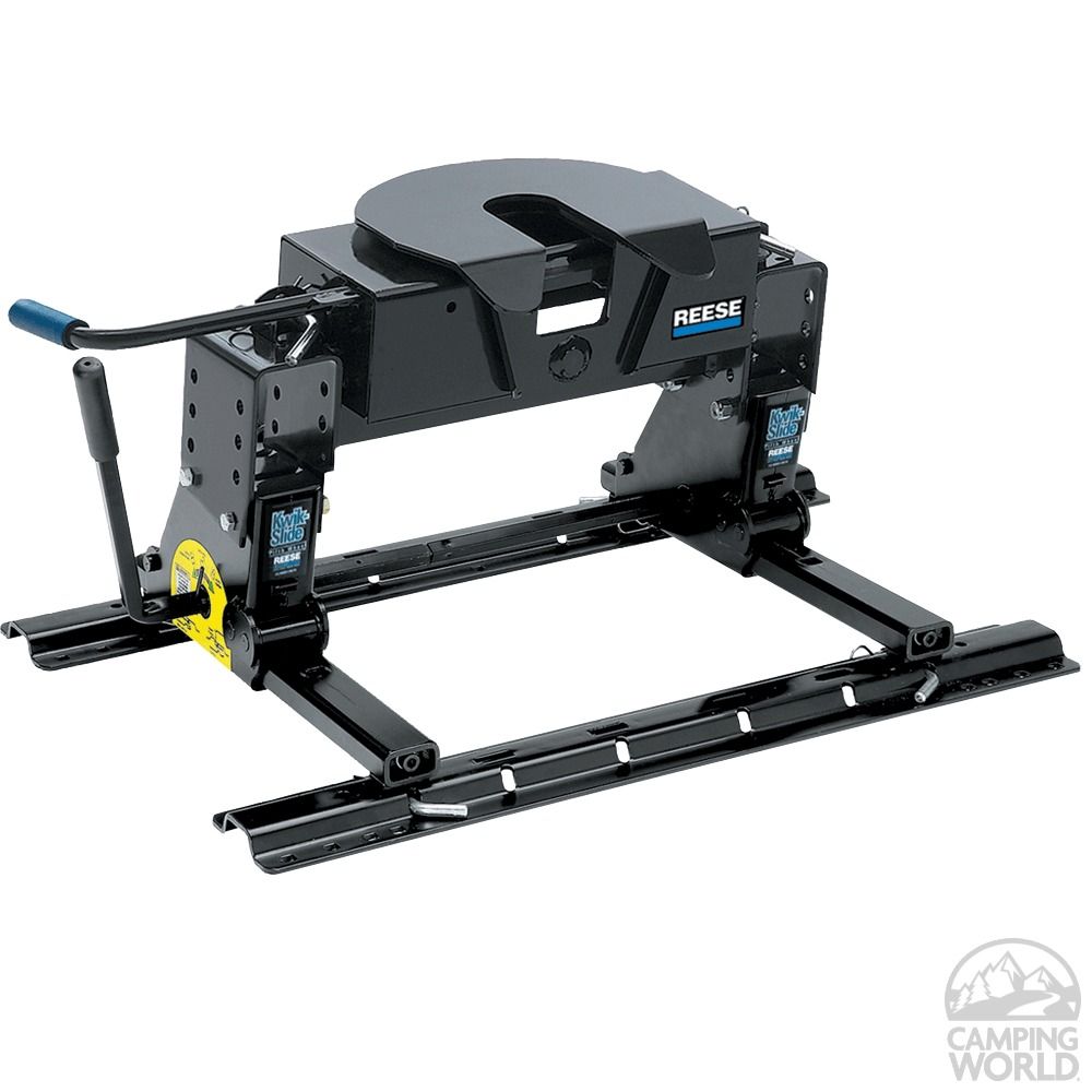

My second choice is this Reese 18K Sidewinder Kin Pin with turret.
Pros... it 22" back (Compared to the 14" on the Pullrite),
Cons.... have to buy that AND a hitch, not sure on the turning clearance, and not sure on ride quality.
